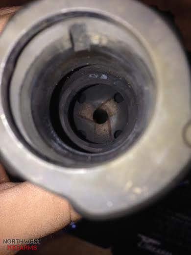

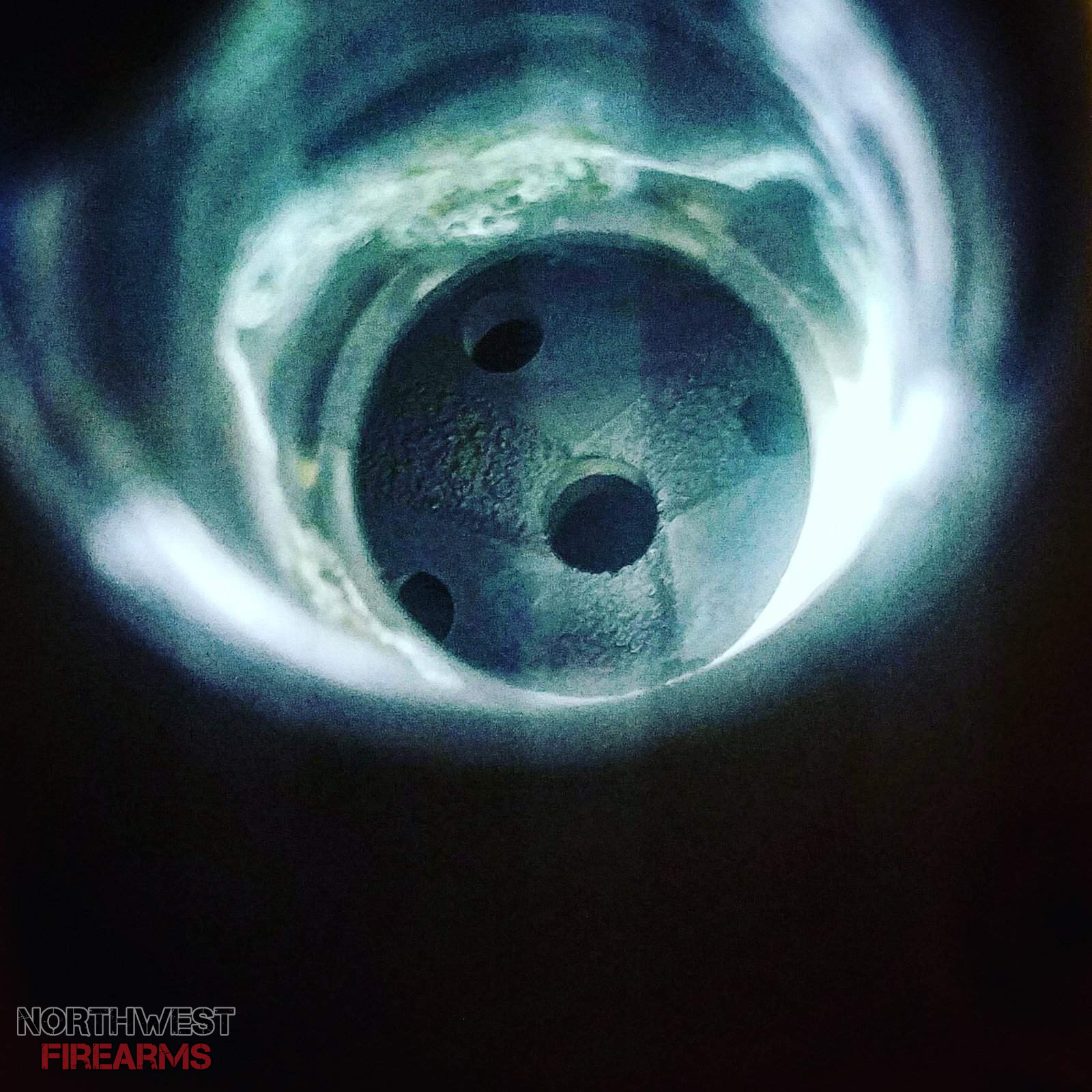

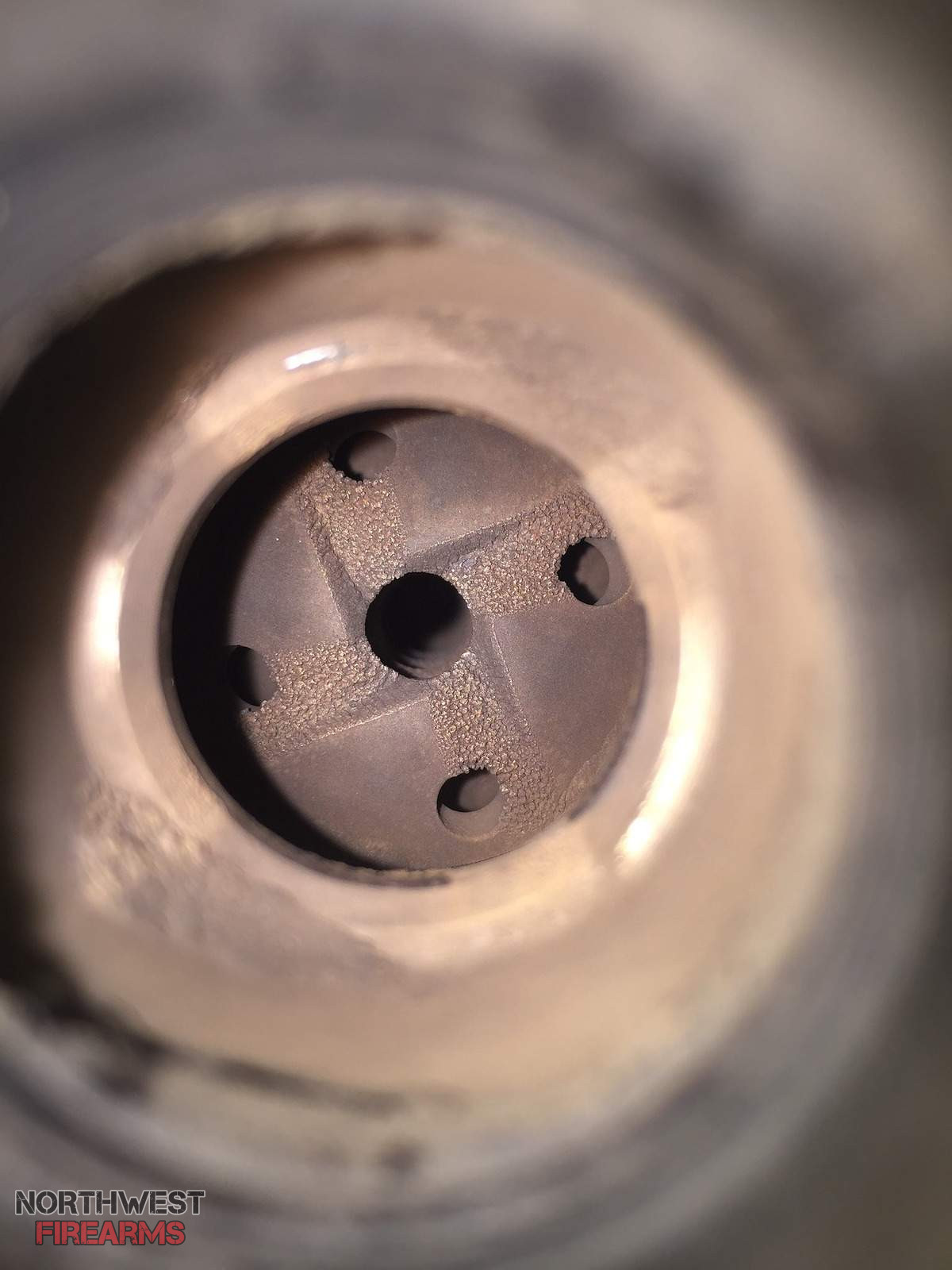

Blast baffles in silencers are not 1/2 inch from the muzzle. I've got 30 cal silencers that gave had many thousands of round of 223 and 30 cal through and they look like the day I bought the but crustier with only flash suppressors.
While your experience is likely legitimate. It doesn't change the fact that supersonic bits of powder and copper and other bits of stuff come out of the muzzle and hit something inside your can instead of the first couple of chambers in a muzzle brake. I'd bet that crusty stuff is pretty darn hard to remove and if you could measure your first baffles opening vs it new, it likely enlarged.

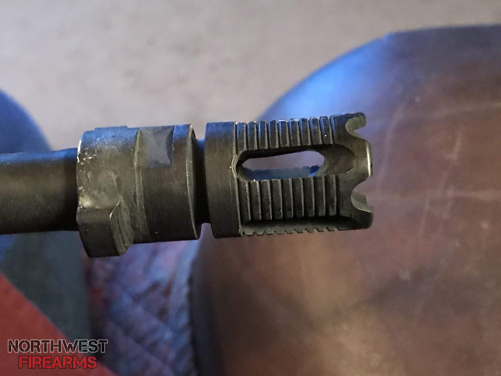

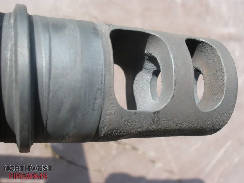

Brakes act as sacrificial baffles.
I agree. Blast baffle erosion is a very real phenomenon, especially with shorter barrels.
With the newer Stellite blast baffles it's not as much of a problem, but considering the YHM Turbo uses an Inconel blast baffle, I'd run the muzzle brake on the shorter barrel just to be safe.
If you truly intend to do most of your shooting suppressed with the shorter barrel, there's no drawback to running the muzzle brake, only advantages. If you find yourself doing a lot of unsuppressed shooting with it, you might consider swapping it over to a flash hider.
