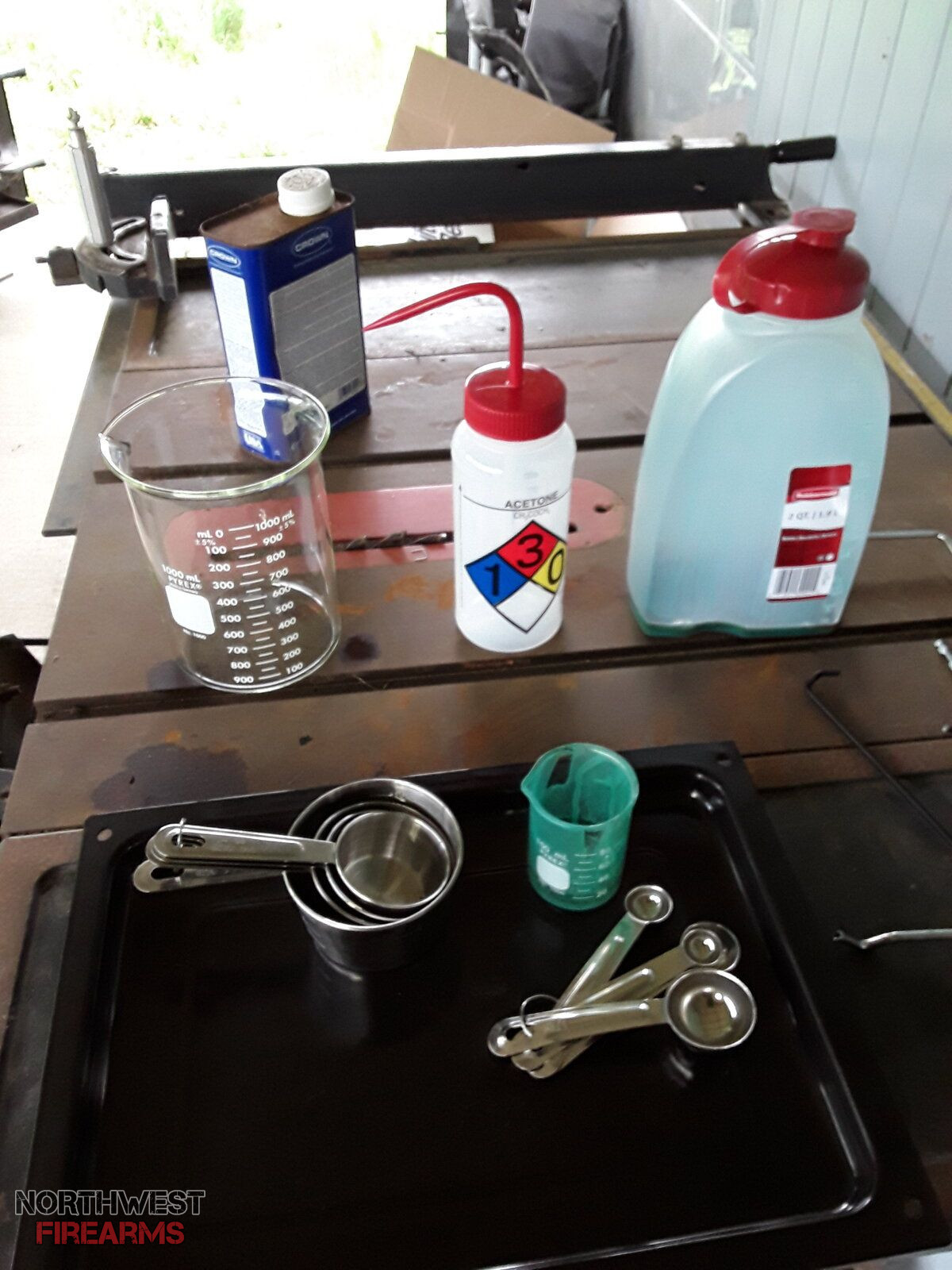

~ 500 rounds of .45 ACP 200 grain polycoat wadcutters. Prepped brass up to priming for another big batch of 9mm 147 grain stuff, and got in some range time before the rain gets to be a lot. Those .45 wadcutters run real nice, didn't have any issues running them in the CZ97 for some " draw from concealment, and knock down plates" practice on the timer. Nice to be able to afford enough ammo to practice with the .45, now! After practicing with my two iron sight centerfire pistols, shooting the Sig with optics was amazingly fast. A very good morning... now it's time to learn how to do Hi-Tek coating on all the bullets I cast last weekend.

Finished: 641903-87b2dc69949985657a8e36ca0be44084.jpg
Not quite the color I was hoping for, but it'll get the job done. "Zombie Green" .
Boiled bullets, baked bullets, fried bullets... bullets jubilee, bullets Alfredo....
