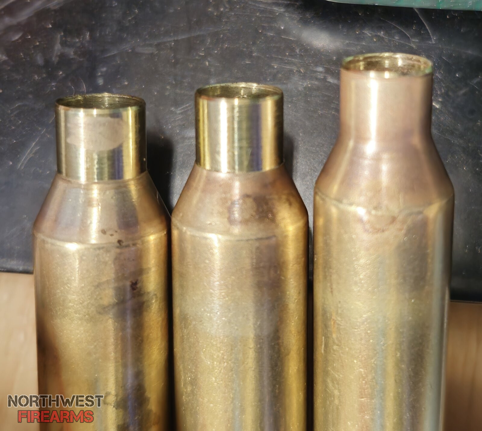

Wow! A lot of therapy going on here.Finished trimming/chamfer/deburr using the RCBS 3 way cutter on the trim pro.
Since the ball head of the 3 way cutter cuts rings into the inside neck of the case, I decided to go forward with neck turning since the neck pilot also uniforms the inside of the necks.
I experimented with how much I took off, but decided to go minimal removal on these first 20. I did sacrifice a couple pieces that already had cracked necks to set it up, and test cutting depths.
First photo shows the case on the left trimmed, showing low spots in the neck. The case in the center was uniformed to the same depth, same settings, but doesn't show low spots. Case on the right was not neck turned yet.

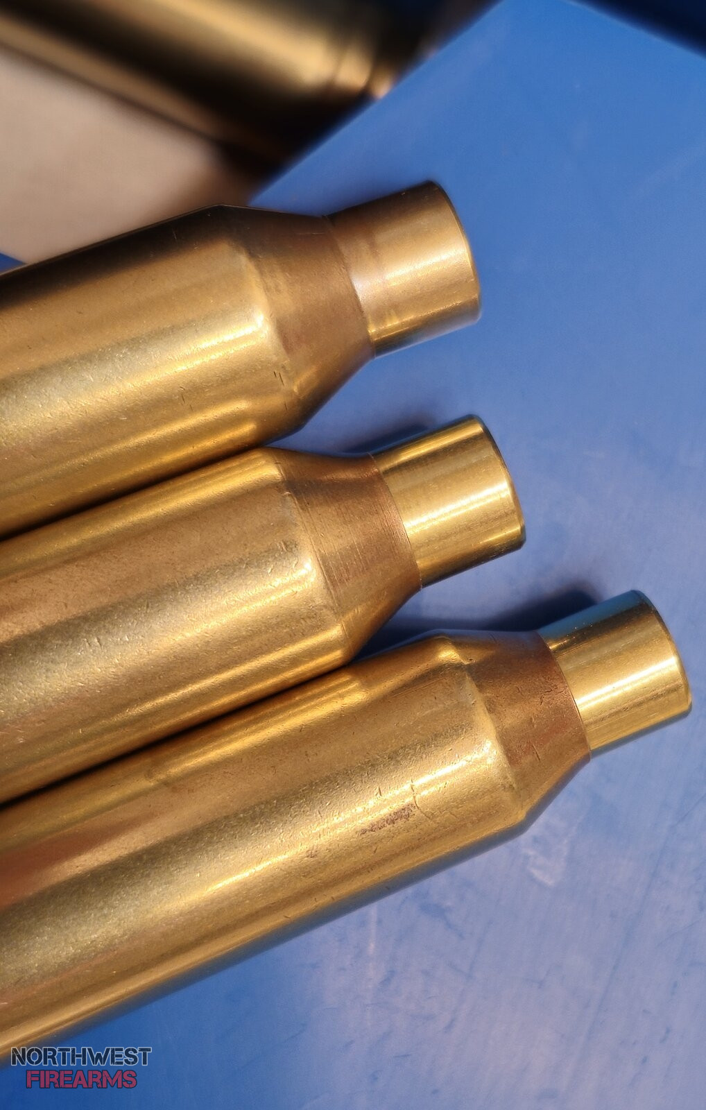

The next photo shows 3 finished cases.
Decapped, annealed, FL sized, trimmed to consistent length, chamfer/deburr, neck turned for uniformity, and inside of neck smoothed. Tumbled in Walnut media for 2hrs to clean up the finish and remove lube.
20 cases ready to load.
I'll pause on the remaining neck turning until I'm happy with these 20.
