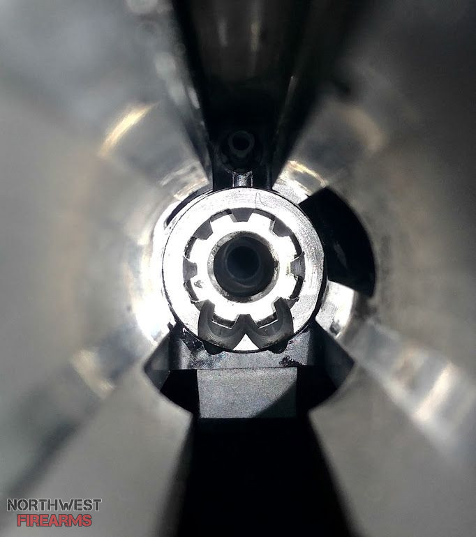

I have a 308 AR barrel that I believe has a extension that has the feed ramps cut wrong. It jams tips of bullets into breech and will not chamber round. I have tried different combos of mags uppers and lowers and have come to the conclusion it is the extension itself. I am looking for a Smith that can handle a rework or replace the extension on this barrel. Thanks in advance.

I looked at some pics of the PA-10 feed ramps....kind of conventional looking dual ramps.
Then I looked at a POF 308
Looks like POF uses a 458 SOCOM type ramp
Maybe that would fix it ?
I would try blackening the bullet on a cartridge and see where the interference is.
Might also have to blacken the barrel extension.
PA-10 (from web)
POF 308AR (from web)

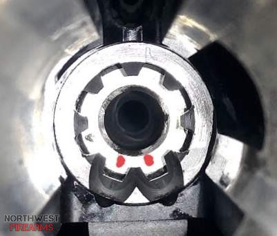

Yes mine is similar to first pic but I do not think the two path vs the uni ramp is the problem. It is the profile of the two ramp areas allowing the tip of bullet to remain too low and hang up just below breech face cone where I marked up the photo. I am considering using a dremel to make two slight lead in ramps on the breech face where I marked in red. I did something similar with a Fal years ago and it runs like a sewing machine to this day.
Thinking about it further it may be the lead in cone to the chamber is cut at too shallow of an angle. The proper fix may be to have this cone cut at a steeper angle so the leading edge of the cone is a bit lower.

Well I got brave and chucked the barrel up in my lathe with some brass shim stock to protect finish and played around until I had very little runout. I then cut a steeper feed cone in the breech and polished it all up. It now feeds very well by hand and I expect it to do the same during live fire. I need to get a gas block for it and finish the build out and then on to live fire testing. I am hoping to get to it this weekend if I don't get snowed in.:eek:
:confused:Just an update on my hack machine work on this barrel. It fed three types of ammo with no hicuups during live fire with two brands of mags. It even fed mag length ballistic tip loads. I love it when things work out without costing me a pile of money. I don't think @Velzey is in any danger of me taking business away though. I would never do this on anybody elses barrel.:cool:

Are you at all concerned about chamber support at this point? How does your brass look?
I was a bit concerned but I really didn't take anymore material than another factory .308 AR barrel I had for an example. I did however examine and measure fired cases closely and can find no evidence of insufficient case support. I also checked headspace before I fired a round and all was good.

Yes it beats the alternative which could have been ruining an expensive barrel. I really didn't take any material where the case was supported, I just changed the cut angle on the feed cone so it ended up wider allowing tips of bullets to engage this taper.
