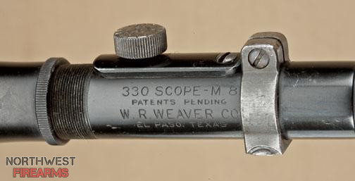

The first scopes used on the M1903A4 were commercial 330's , the a more ruggedized version called the C330 M8 was made to correct problems with the commercial 330 , the final version is the M73B1
Here is a M8 compared to your commercial scope
Here is M73B1
As I said earlier a commercial scope can be correct for a very early 03A4 but the scopes did evolve and while they do not say US on them they are marked as such along with having finger adjustments versus needing a screwdriver . The other differences were reticles.
The early 330 commercials had fine cross hairs, later in the M8 they went to a post , then a post and cross wire in the M73 B1
