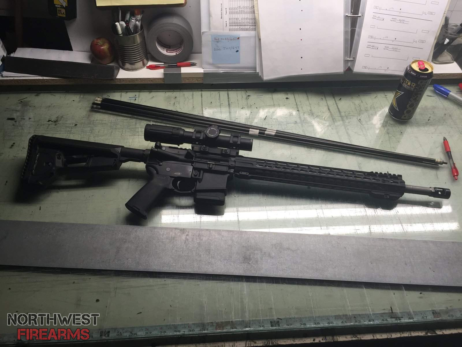

Combining an A5 buffer system with a mid-length gas system and a properly port barrel makes for an amazing smooth running carbine. Compared to an M4, I firmly believe it is also a major factor in extending component live span for people that do a lot of shooting.
@Cerberus Group built a 14.5 LW middy after shooting the 16" LW I've been working on, I'm pretty sure he is convinced it is a step up from a standard carbine system. I look forward to checking it out next time I"m up there.
I was able to shoot tits' and another student's rifles with the A5 buffer system last year, and run some drills as well...and noticed an immediate difference from my 14.5 mid, with a H buffer and standard spring.
I had a build in progress, so added the A5...and have about 1,500 rounds through it. It is one of the most flat recoiling rifles I've shot...
I also upgraded the other one mentioned above to a H2 buffer and Sprinco "blue" spring. They are a lot closer in performance, but there's still a positive difference.
I've also seen the premature unlocking mentioned in the article, which puts wear on the bolt lugs, and if a cheaper made bolt is used...extreme wear.
The A5 system is as stated in the article...it is one of the best upgrades one can do...and I'm not into gimmicky crap.

I run a A5H3 in my SPR build.
I really like it.
With an adjustable gas block tuned down a bit it's recoil is really controllable and it's a really enjoyable rifle to shoot.
