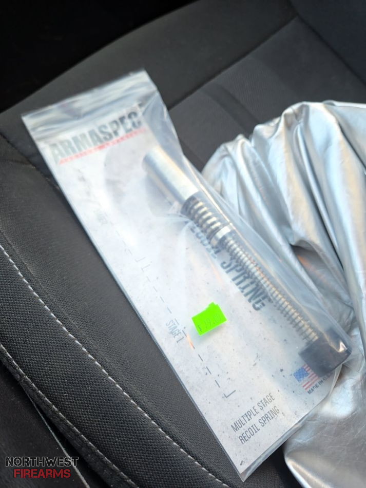

I have an 11" gun that throws cases between nearly 12 o'clock and 1:30-2. It has the "normal" H buffer in it. Spring unknown.
Curt's is the local AR parts place. I went in last weekend looking for an H2 buffer, or maybe even an H3 and planned to buy a spring of known quality at the same time. Talking to the owner, they are our of buffers! Then he pulls this thing out and says that it's an H3 equivalent. To me it looked like a complicated answer to a simple problem, but I decided "WTF?" and bought it.
I can get pretty impulsive and figured out at worst I would find out why the schmarter ones here recommend what they do. Ya only get experience one way...
I was able to take the gun out the very next day to see how it worked and was pretty disappointed to find out that the new "thingie" didn't change the ejection pattern one bit. It did take away the sproing noise out of the butt. Don't have a clue if it changed the recoil impulse at all, as I think these are easy shooting guns. Do any of you have an opinion on what I bought? Not the fact it didn't solve my issue, but are these things worth a damn or is it a gimmick?

No matter what, my gun seems to be over gassed with ah H buffer. What weight would you guys recommend I buy?

An a5, rifle or heavy carbine buffer won't fix heavily over gassed, think of it as a fine tune.
What you need is a coarse adjustment, adjustable gas block or similar gas restriction method.
That said I run A5 or rifle buffer/spring in everything I can.
They are superior to carbine in my opinion.
I think they're gimmick...but then I tend to stick with tried and true tested engineered buffers and springs.
I'm not into adjustable gas blocks, as I've seen many disintegrate over time from the gas. If the adjuster screw isn't turned now and then, they will carbon themselves in place, and will no longer be adjustable.
Another thing, there are variables that factor into the ejection pattern...just because it's dropping the cases at 1-2 o'clock, doesn't mean its over gassed. Buffer and/or spring rate along with extractor shape and tension, strength of ejector spring and even the shape of the ejection port and deflector can influence the pattern.
I'm not into gas blocks, as I've seen many disintegrate over time from the gas. If the adjuster screw isn't turned now and then, they will carbon themselves in place, and will no longer be adjustable.
How would I differentiate between being over gassed and other issues?
