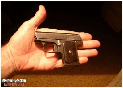

I received a model 1911 Victoria 6.35 many years ago:
Missing the main spring. :s0076: And I mean MAIN!
With just one spring, it operated the hammer, the Sear, the magazine retention, and the mag release, all unbeknownst to me (not that it cost me anything). I had no clue what it looked like, what it operated other than the hammer and could find no drawings, looking for years on the internet, gun forums, and parts houses. Internals were totally unlike baby Browning's and copies thereof. So for the next couple years; I started conceptualizing, drawing, building prototypes, heat treating, tearing apart and reassembling many times the little thing, until I hit on a V spring shape shape that sorta fit the bill. :)
I finally tuned it with six or more reiterations trying to get the spring heat treat, temper, metal thickness just right.
Each time annealing, cutting, filing, polishing, heat treating, annealing again each and every one, some breaking some just not enough to snap a primer reliably, or, I'd get the hammer to work well but the sear part was way to heavy. :eek:
All in all I figured I made over thirty different springs starting from scratch each time.
This, after making several tools to compress and insert the multifunctional spring prototypes again and again, a challenge all on its own.
Finally I had one that did it all. :cool:
I still don't know if it looks like the intended, but it works, and works well.
A broken one or even sample would have been too much to ask for it seams but a drawing would have been sweet, having it be a coil spring even sweeter! ;)
