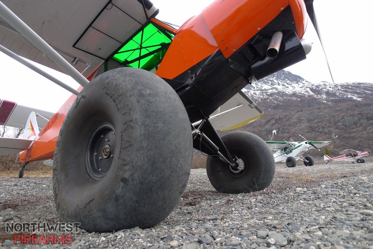

So, As some of you know, I have a Super Cub on 31" tundra tires! They are great for what they are intended for, but the major problem is they wear out super fast and are super expensive to replace as in $2500 each!:eek: I had mine re capped by Goodyear, but that is only a bandaid for the real issue!
What I am looking for is a Ag or Sand tire that is close in size or even taller/wider for flotation!
I am also looking to up grade my brakes from the super small "Standard Size" 8" diameter rotors to a ATV/UTV brake system to loose more weight and increase braking power and decrease cost of replacement!
This is what I have and am looking to replace with a better wearing balloon tire rim combo!
Any leads or Ideas?

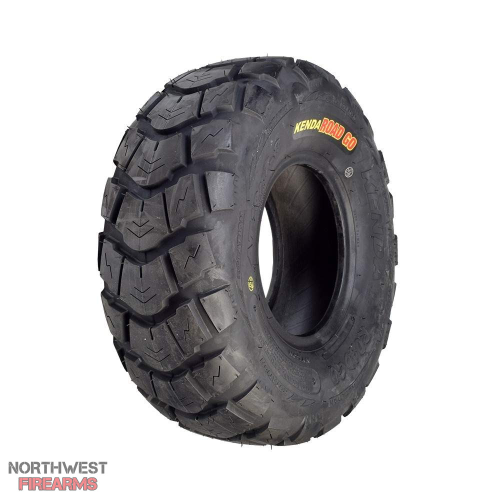

Closest I can come up with (and that's not including some agricultural applications that I don't know about) would be ATV tires.
Since they often come in larger diameter sizes on smaller diameter rims, they may have enough material to offer adequate shock absorption, which is the whole purpose of the 8" rim and 31" diameter.
Unfortunately, in searching ATV tires, the taller they are, the bigger diameter the rim. In a 31" tire, the smallest rim diameter is 14". I don't think there's enough sidewall there to give you the amount of shock absorption and flotation you need for your application.

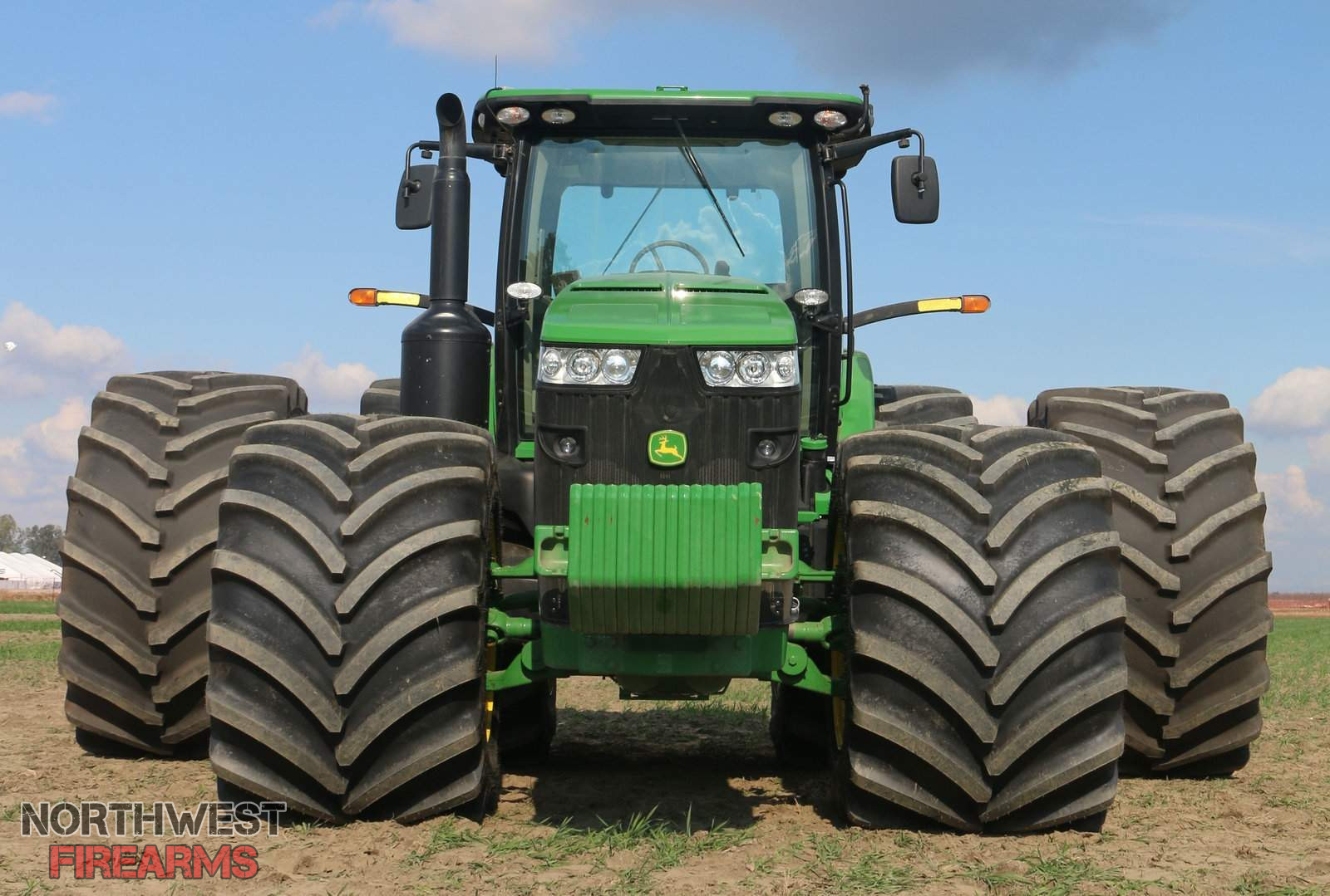

This is why I'm thinking an Ag tire like you would find on drag equipment. As long as any tread is groves only, that's fine! Back before these Alaska Bush wheels, Goodyear made Aero wheels that were kind of the grand daddy to the new stuff, but the whole problem is tread life now days really really sucks ( like a $20 bill every time you land or turn ):eek:

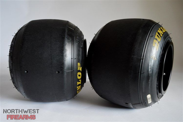

! A lot of Old Timers would use Micky Thompson Racing Slicks and use the lightest automotive wheels they could find! I thought about that trick, but the stiff side walls would make cross wind landing's wicked nasty!

The problem with any tire option is tread, if it has a tread pattern, it will "Hook" on things, and toss them into your $4500 prop, or through the bottom of your wing! Watched The guys @Sherpa aircraft, as part of a promo video in on their bad arse plane, put a set of Boggers on a million dollar bush plane then went out and blew a prop apart and had to hire a large rescue helicopter to hoist it back home!:eek::eek::eek:
So, part of the issue is the tires need to be almost a slick! And, we some times land with our brakes locked or almost locked and using friction of the slide to come to a screeching halt! Dosnt matter much what you land on, that kills tire life! With these Alaska Bush Wheels, even sharp turns on the ground ( like getting into/out of my hanger ) really wear on them!
The whole idea of why they dominate the market is they have an integral innertube that fills from the side wall, this prevents the possibility of ripping a valve stem off doing a aggressive landing where the tire can actually spin on the rim! Bead locks do work, but there are no options other then an auto motive rim and tire, hence the racing slicks and bead lock racing rims! That worked for a lot of years, but led to a number of accidents from breakage, so the bush wheel fixed a lot of that! With more and more pilots discovering the fun of bush flying, the lower costs of getting into this hobby, and the slowely expanding market ( and after market) there is greater need for alternate options, mostly because even us hard core bush pilots dont like spending that kind of money, and with suspension options growning almost daily, the reliance on the bush wheels is lessening!
