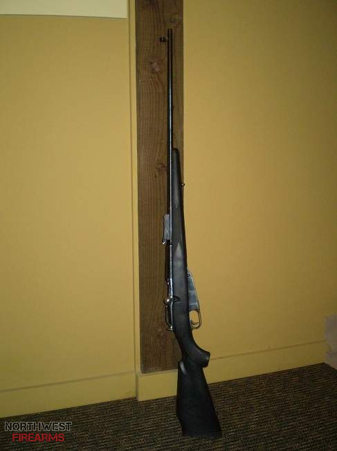

Traded my Mauser for this Mosin. Its an ex-sniper, and came with an ATI Monte Carlo stock. Trigger does have the standard play, but is crisp when it releases with very little movement of the cocking handle. All the machined surfaces of the bolt assembly are pretty smooth compared to how my other 91/30 was. It hasn't been counter bored, but the rifling at the end is a bit worn, so I will have to test it out.
I will take this one out shooting later on to see how it does. I may end up cutting the barrel down to get to good rifling and thread it for a brake, then cut the one I already did down to 20" and rethread it. One thing I noticed is that it doesn't fit in my Archangel stock. Too wide at the back of the receiver, so I'll keep it in the Monte Carlo for now. Still trying to decide on the brake to use. MosinS.JPG

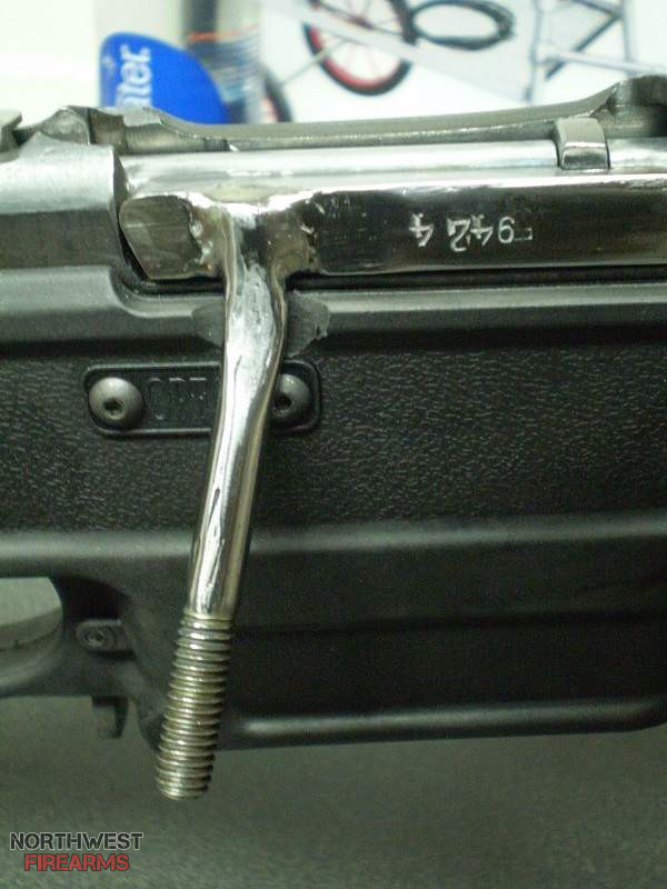

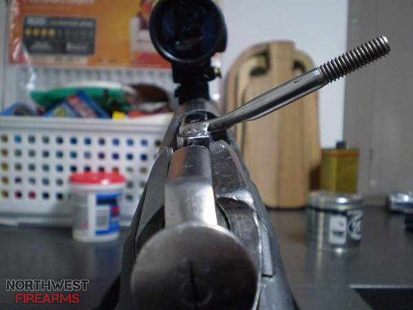

Decided to make a different bolt handle. Still need to finish shaping it where its is welded to the bolt, but my Dremel battery died. As it is, it clears everything, but I am still going to flatten it a bit and blend it some. Used a 5/16" bolt. Bench vice, torch, and a piece of scrap pipe to bend it. newbolt.JPG newbolt2.JPG newbolt3.JPG

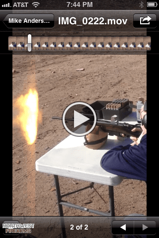

Windsor, stay at 20. I've cut to 18" as well as 16.5. Both of the shorter guns I sold or gave away. Not that there was anything wrong with the gun, but they started to keyhole with the heavier bullets. At 20" I have not had any heavy rounds keyhole. Lack of twist I would sum it up too. The 16" one I fuglytacticooled, it was nicknamed the dragon as it spit a pretty nice flame. It was a cheap pick up anyway, some kid hacked at the barrel to 17ish inches and cut up the stock. I made the most of it seeing it only cost me $50. I gave it to a friend before leaving Reno. I'll get a pic once on a computer.

The fuglified tactical Mosin Pic as promised. Trust me it was uglier in person. It shot well though, so judge lightly!
