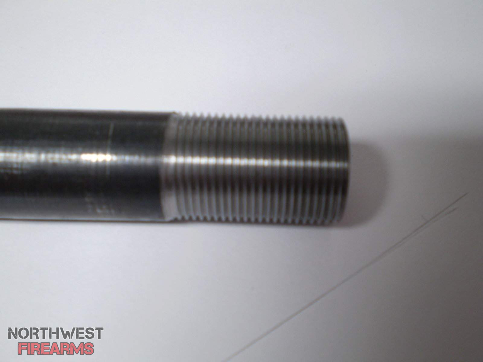

Brake came in today. I like it. Threads on well and looks good. I ordered this one from Viperspeed on ebay. It is actually a CNC Warrior part. On CNC Warriors website (where I got the threading set), they have the Cross Brake that has 2 ports on each side and top, but I didn't see Slingshot (3 port version) on there.
I'll finish threading the mosin today and get this installed for the fitted pictures. image.jpg
001.JPG 002.JPG 003.JPG 004.JPG 006.JPG Here are a few more pictures. The one showing the manufacturer marks is crappy, since I couldn't get my camera to focus on it. It is CNC USA.
Hopefully, next week I will be able to get the facing/crowning set and get it done. But the pictures show what it will look like.
When I inspected the brake, I noticed that a spot was sticking into the bore. I used a round file to get it right, which only took a couple swipes. Once installed, I checked the alignment visually first, then I used the TAT. With the TAT in the bore and fully seated against the brake, it went into the bore .336" (put an ear plug in the bore and pushed it down when putting the TAT in, then used my depth mic to find out how far it went in). Both visually and with the TAT, the alignment looks pretty darn good.

For those with a mosin or two and are willing/interested in doing this, it is fairly easy to do and mine turned out well. Yes, there is a chance that it it may not work for your rifle. Your bore can be too far off center, or something like that. And yes, the section you are threading needs to be the right diameter (bore centered). But it can be done if you understand that things can go wrong, you are cutting up metal that can't be welded back on, and you need to take it slow.
If you are like me, and enjoy doing things that "shouldn't or can't" be done, it's worth the cost. If you aren't sure about doing it yourself, PLEASE atleast talk to a REPUTABLE gunsmith. If you do it, PLEASE measure multiple times before cutting, and quadruple check that everything lines up PRIOR to shooting.

No pics yet. I got the threads started last night. I have a mosin at 20"s and it performs well, so the one I'm threading I wanted to cut down to 20 from the original 24. I had to push the die all the way out as far as it would go while fitting in the tap handle. Seeing as where I am threading mine is much further in on the barrel my diameter is too big. So I took the end of the bore, about an inch worth, to the belt grinder, removing just enough to get the die started, but I also tapered the end heavily to assist cutting with the die. I ordered a CNC Warrior flash brake and will wait till I get it, hopefully next week. I will the finish threading as well as adjusting the die to cut the threads deeper. Pretty much following the video link I posted earlier.
I'll have to sand the barrel near the threads a bit to get back to a perfect contour.
