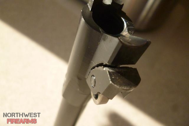

The year was 2018, a nearly new SR1911 stoked with Federal Trophy Bonded 180 grain. Advertised velocity 1250 fps.
I have witnessed a couple more mini-kabooms, including in a Glock 20.

What were the damages and was the cause determined ?

The cause was never determined. The barrel underlug was severely damaged, and whatever else was stretched at the same time. Neither Ruger nor Federal was much help. Ruger Replaced some parts including the barrel, but the pistol never would run as it should after that. Ultimately after much heartburn and pushback from Ruger, Davidson's replaced the pistol. That particular SR1911 was the most accurate 1911 I've ever shot.
I've read of another half dozen that had the same failure during the same period of time. The 10mm cartridge, fully loaded, is hard on pistols.
I was aware that Ruger forges their metal firearm frames (and slides on semi's) instead of milling from billet which is why they are 'over-built', but I can't imagine they do that with their barrels, which lends credence to the idea this was a bad batch of barrels. While 10mm is hard on semi's, it's nothing like 460 Rowland, and I've converted a XDm 4.5, G21, and a Springfield RO 1911 Gov't to that caliber, and they all hold up just fine, in fact the 1911 is the best shooting, most reliable. So I'm not sold on this being an ammo issue, certainly not with a Federal round since they are still loading those to the watered down FBI (pseudo 40 S&W) charges. On a related note, I tried one of the Henning Group's brass buffer rings in my EAA Witness and within 50 rounds, that buffer got dis-formed and it took me months to work up the courage to smack the back of the slide with a rubber mallet to get it off the lower. All's well with it, no worse for the assault, but totally not worth the slight reduction of wear and tear. Just say no to buffers :D .
