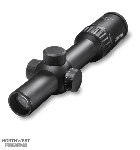

Here are the features listed on the Steiner site: P4Xi 1-4x24
  • ONE PIECE 30MM TUBE for increase strength and reliability.
  • 4X ZOOM provides maximum range at the high end and true eyes-open situational awareness at low magnification.
  • CONSISTENT EYE RELIEF and a generous eye box throughout the magnification range.
  • LOW PROFILE TURRETS / ILLUMINATION CONTROLS are less likely to hang up or snag during movement.
  • ILLUMINATED RETICLE with 5 day/4 low Light/2 NV levels. An "Off" position between all 11 settings completely disconnects the battery at each off position to prevent battery drain.
  • WATERPROOF/FOGPROOF/SHOCKPROOFdurable construction you can trust to stand up to any cold or wet conditions.

  • Really clear glass, on par with Trijicon accupoint 1-4. I could see holes in paper at 25yds at 4x. No distortion or blurring of any kind on the edges.
  • 1x is very close to being a "true" 1x. No fisheye effect at all, but there is magnification if you're looking at targets inside of 5yds. (I think every variable power scope does this, the Trijicon Accupoint definetly does.) Very easy to shoot with both eyes open.
  • Illuminated dot inside the reticle is very bright and daylight visible. The illumination knob has an off setting between each illumination setting.
  • Build quality is very good, you can tell from handling it that it's a very high quality product.
  • Capped turrets.
  • Included throw lever (Need to buy product number 5202 to get the lever.)
  • Comes with an extra battery!
  • Steiner CS has been very good so far, I've called them a couple of times to ask questions about the scope and was able to talk to someone quickly each time.
Cons:
  • Eye box is not as forgiving as the Trijicon accupoint 1-4. You need to have a good and consistent cheekweld to not get shadowing on the edges of the glass.
  • Turrets are mushy, it was a little difficult to feel and hear the clicks. When I was zeroing I turned the turrets too many clicks on couple instances.
  • Turrets are not zero reset turrets, but they are capped and meant to be set it and forget it.
  • Weight is 17.3oz
Overall I'm very happy with the Steiner P4Xi 1-4! Yes the Trijicon Accupoint 1-4, and Accupower 1-4 (which is supposed to be have similar glass and features except for illumination and reticle) does have better turrets and a more forgiving eye box but neither have daylight visible illumination. They also cost at least $300-$500 more than the Steiner.
For me the Steiner is hard to beat. It is miles better than the Truglo 1-6 that I had before and the build quality and glass clarity rival the Trijicon offerings. I don't think there is any other low variable power scope in the price range that even comes close to the Steiner in terms of features. I would recommend it to anyone looking for a high quality, made in USA 1-4x24 scope under $500.
