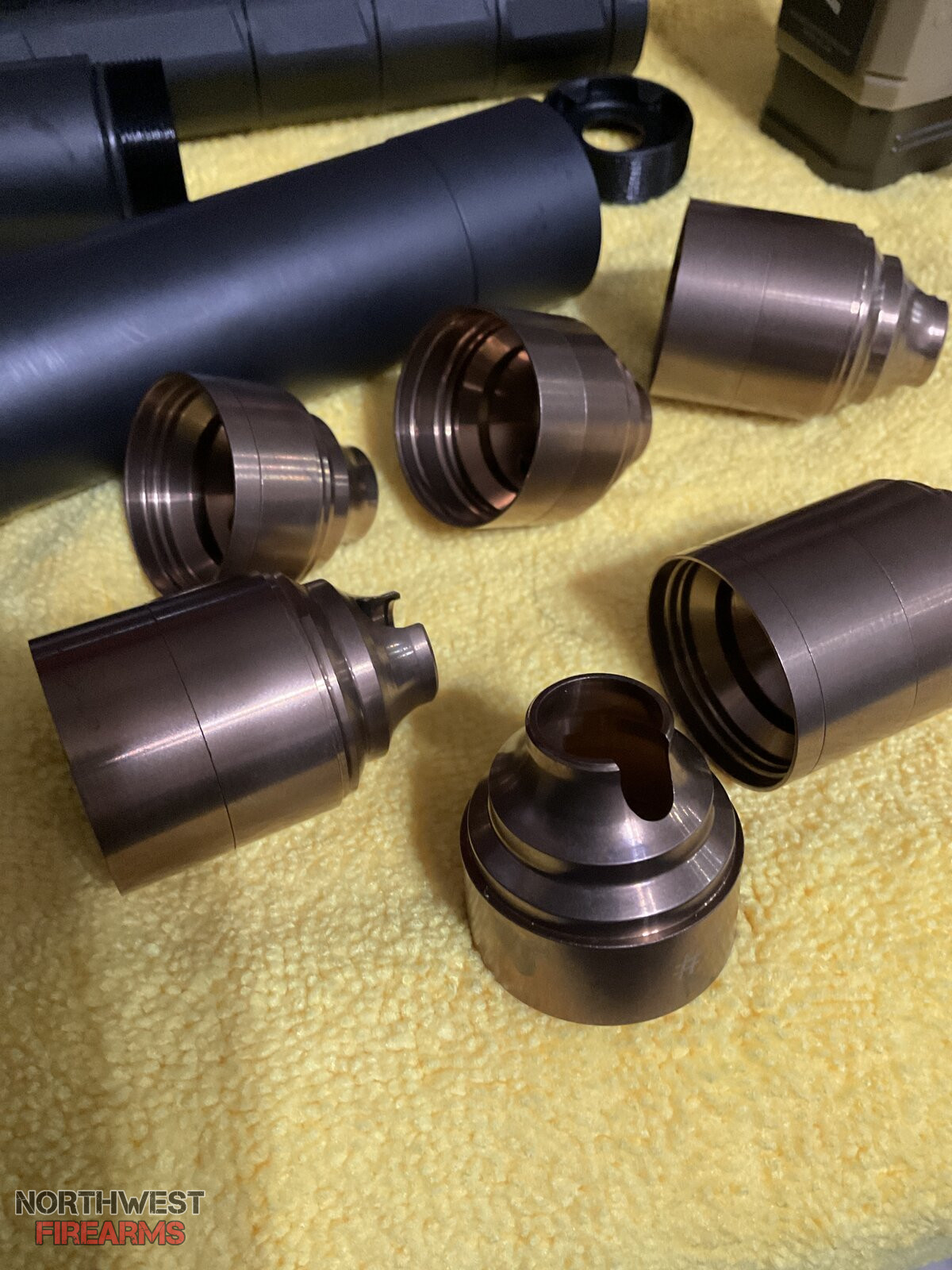

I just picked up my new Rugged Obsidian 45. I'm in the process of taking it apart, but can't for the life of me get most of the baffles apart. 🤣
I had thoughts of a hammer dance through my head, and decided to post here before I let my inner cave man have at it.
I know that it's new and all, but holy crap! This is really stupid.
My instinct is to grab a wooden dowel and a hammer, and whack the crap out of it. I'm going to bend them all up, if I keep wrenching on them with my man mitts.
ideas?
-Matthew

Tried last night. Still no go after soaking, and getting them so hot I was burning the holy livn' tar out of my hands (not bare). Wife was making fun of me…
I agree, they should just pop apart per manual. If I can't get them apart tonight, I'll get ahold of Rugged.

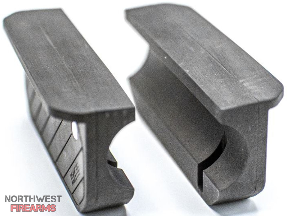

Get a set of Otis soft vice grips. Then place baffle in grips. Use Allen key to pull apart.
These also help if you ever lock up a front cap.
Another way to do it is to leave the baffle stack in the tube, minus the one you want to pull apart. IE have the baffle seam out of the tube. Use the tube as leverage to pull the exposed baffle apart using the hex key.
