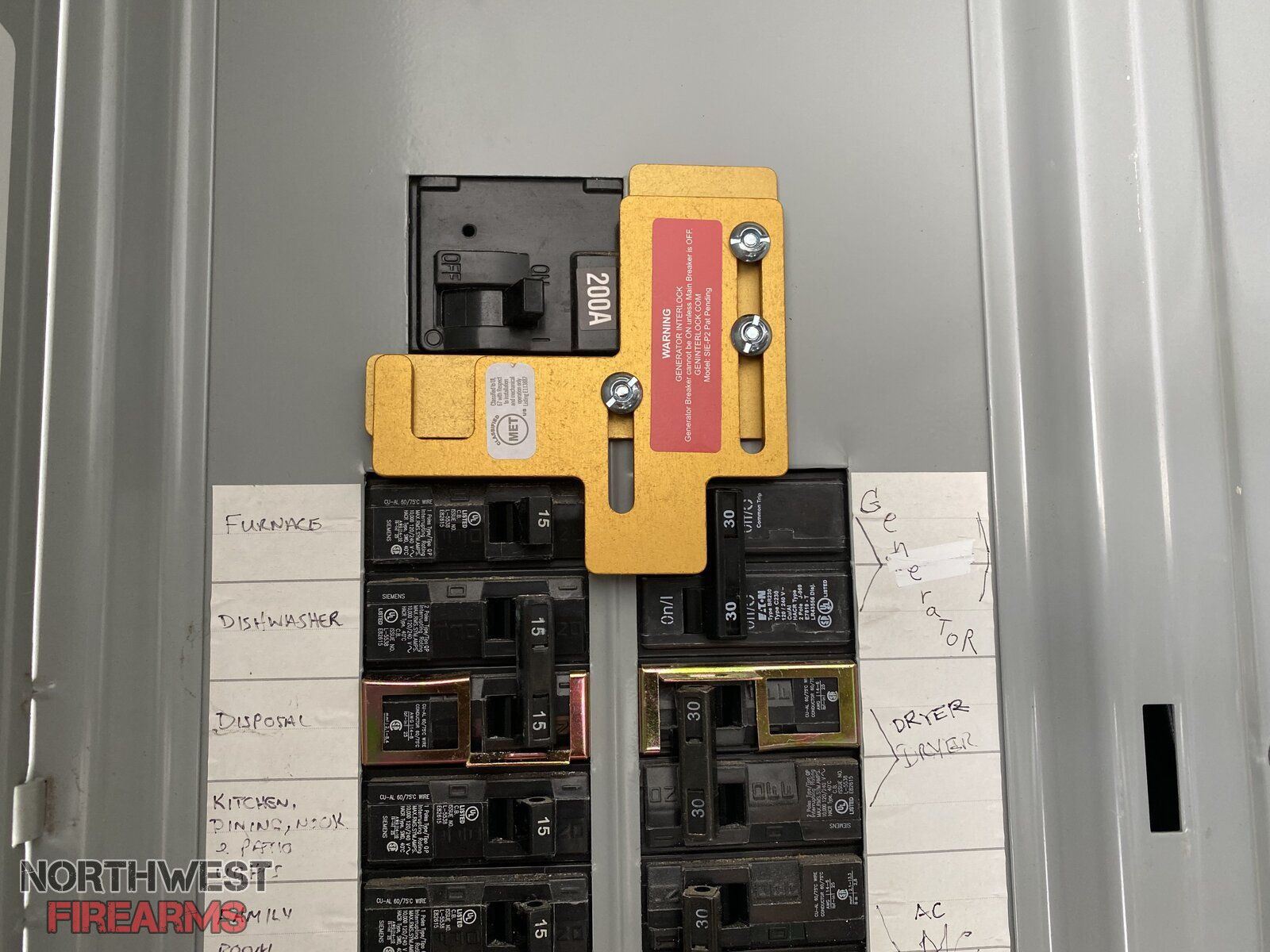

Had the sparkys come by last week and wire up transfer switch, already have 2- 10kw generators but wanted to be able to plug into the panel instead of running cords. I live in town tho, so don't usually lose power. I need a better way to store fuel, right now just using multiple 5 gallon VP fuel jugs. I would like to get a 55gal drum with hand crank pump eventually. Hope you get power restored soon. Stay warm.
Panel cover generator interlock kits are the way to go for the homeowner. Power up all circuits if you have a
240 volt generator. Pretty simple to install. Interlocks the 'Main" breaker with the generator breaker so either
one or the other can be closed but not both. Scroll down to see several brands of panel kits. Retired Electrician.
Yes, this is what I had installed. Thanks for the clarification. Also has a big ol dangly to hook up to the gen.
