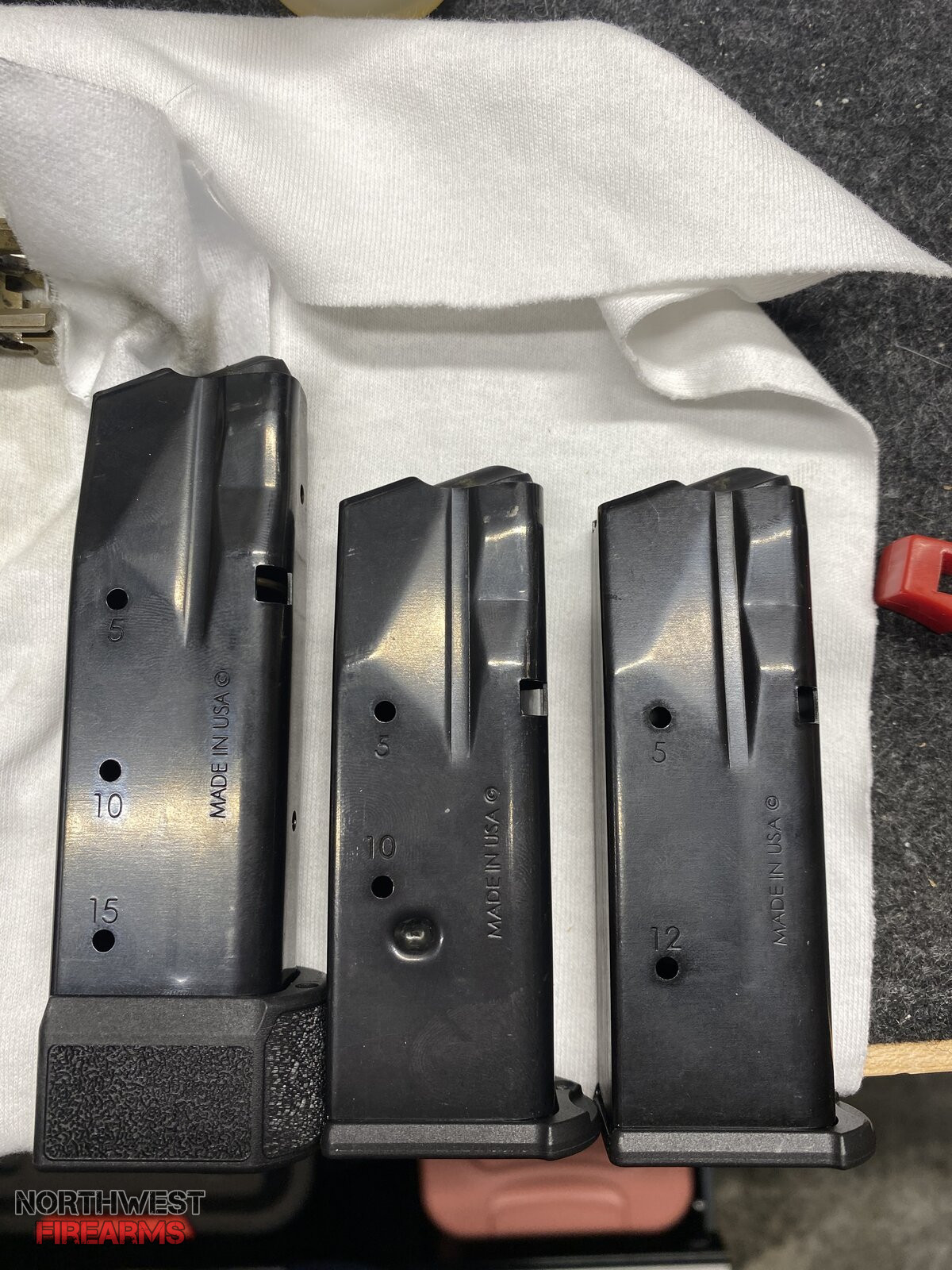

Dimpled mags like the OP's? I know how you feel but I screwed up there. I have an aftermarket XL frame and just assumed that 10 rounders were flush fit while 12 would have an extension. Imagine my surprise when I got these in the mail:
The 12-rd magazine is a flush fit with the XL sized grip modules. The 10-rd sits flush on the smaller P365 sized grip.
I know you know this, but others may be a bit confused.
If you buy the 12 or 15 round magazines, you will get two baseplates.
On the 12-round magazine one provides a flush fit on the XL sized grip and the other fills in the gap that would otherwise occur when using the 12-rd stick in a standard 10-rd sized grip module.
The 15-rd magazine has two filler baseplates of different heights. One fills in the gap when used with the 12-rd XL grip and the other fills in the larger gap when using this long magazine in the shorter 10-rd P365 sized grip.
I'd post photos, as I have all the permutations, but I'm out the door to work in a few. If anyone wants them let me know and I'll post them up tonight or tomorrow.
As far as the dimple, drill it out. Go a bit bigger with the drill bit than you might think. It won't hurt the mags strength and will function just fine. The same spring is used in the dimpled and undimpled versions.
I use a drill press and a block of wood inside the mag body to reduce the amount of flashing / burr created by the bit. You can also "double drill" to reduce the internal burr. Drill all the way through with a slightly smaller bit then come through from the other direction with the larger bit. That will remove the flashing / burr on the far side hole as you do the final enlargement. The tiny amount of burr you will have now on the entry side hole is easily removed by flipping the magazine and coming back the other direction with the final sized bit. That will clean it up nicely.
It takes about as long to do as it took me to type the above. Let me know if this is not clear and I'll happily try and confuse the issue even more!
