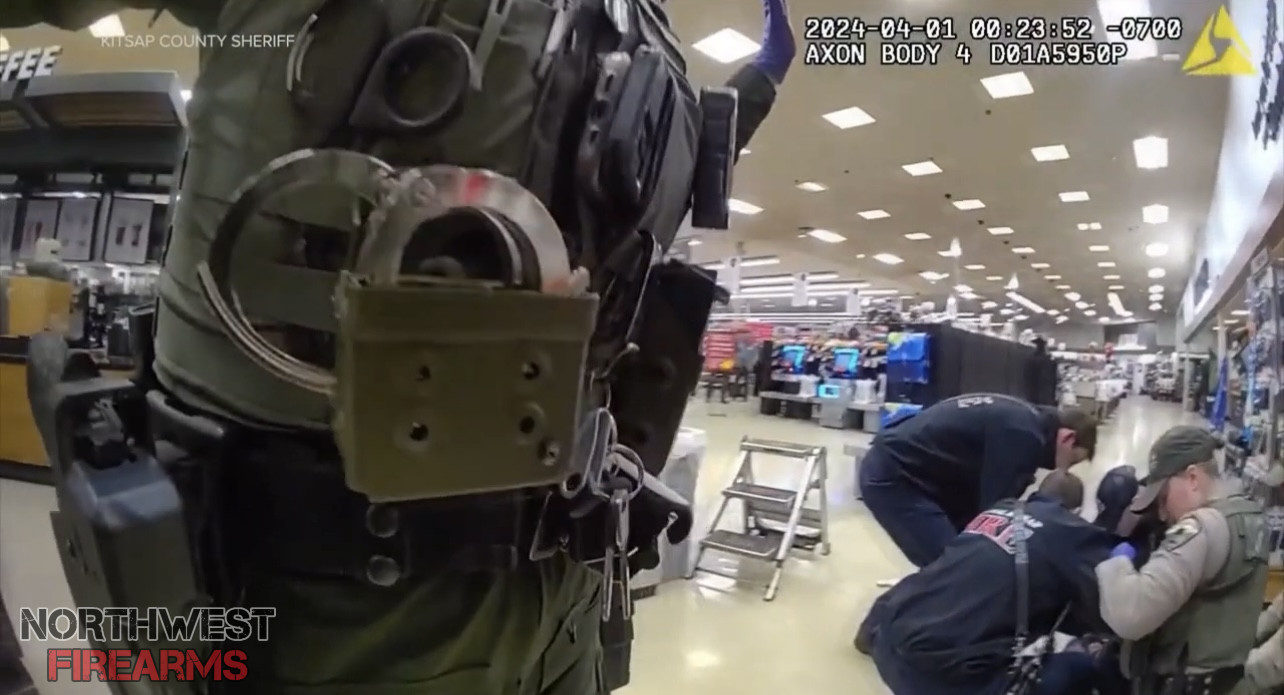

<quote> "I don't know if it went off in a holster," said another. The bullet did not strike or injure anyone.
Given the P320's controversy among police agencies, Kitsap County launched an investigation.
It determined that a loose "strand" from the deputy's handcuff swung into the trigger well of the deputy's holster during the struggle. That was "responsible for pulling the trigger" the final report a month later concluded. " <unquote>

What is a loose "strand" from a handcuff? I would like to know.
And what kind of terrible holsters are they running?
Guessing the hooked part once ratcheted out of the frame. With the current design of many duty holsters now, I could see this part of the cuffs getting to a trigger.

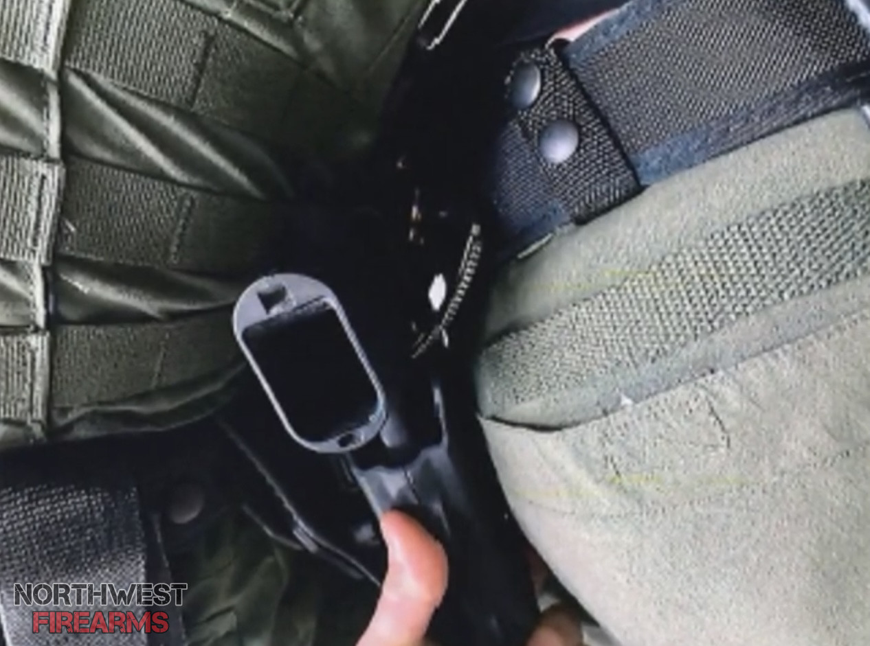

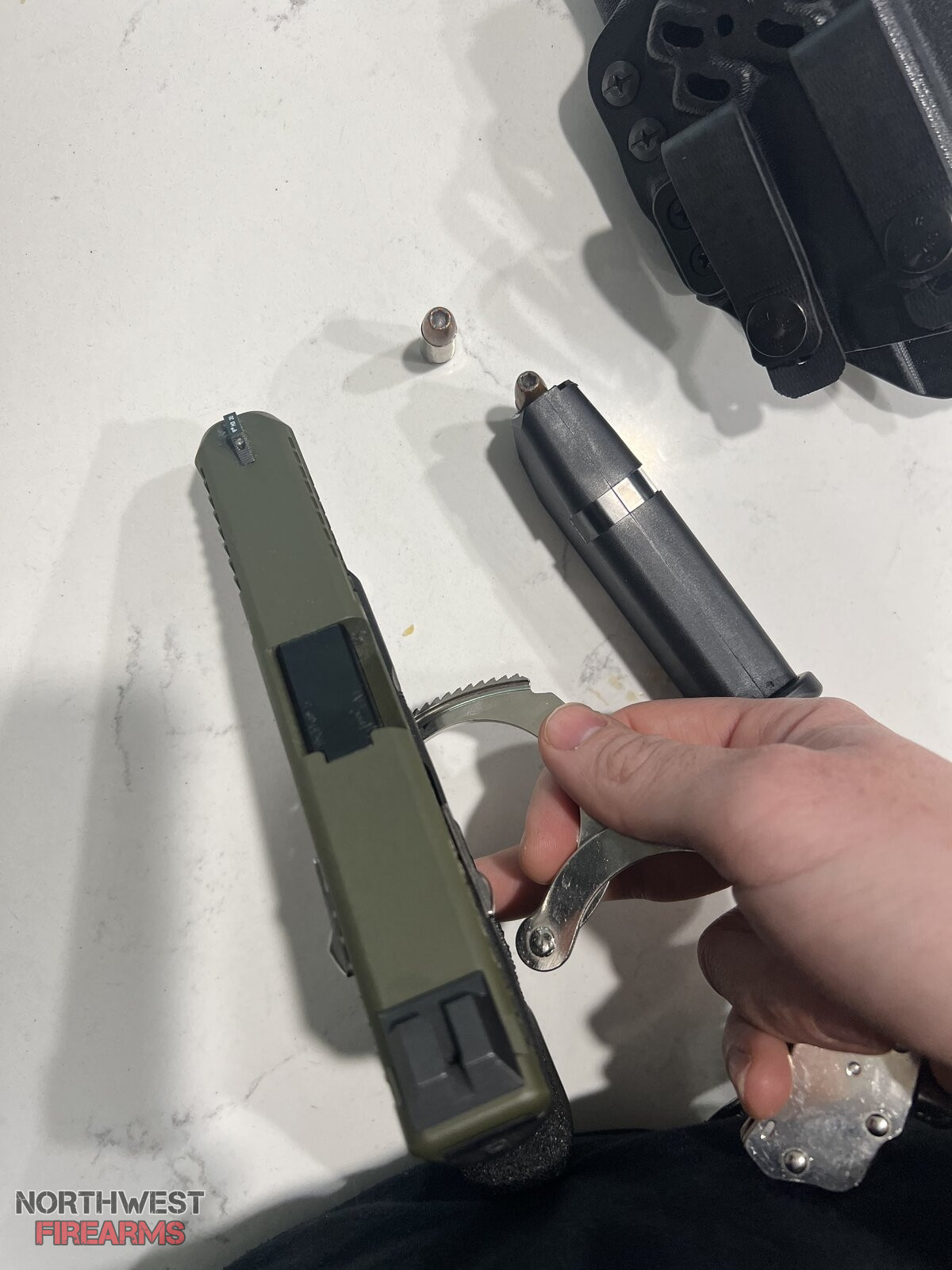

But I do not see how the ratcheting portion of the hadcuff could access a trigger. I just pulled out a Glock and a set of cuffs no matter what angle I try I can't snake it down into the trigger guard. The space needed is huge.

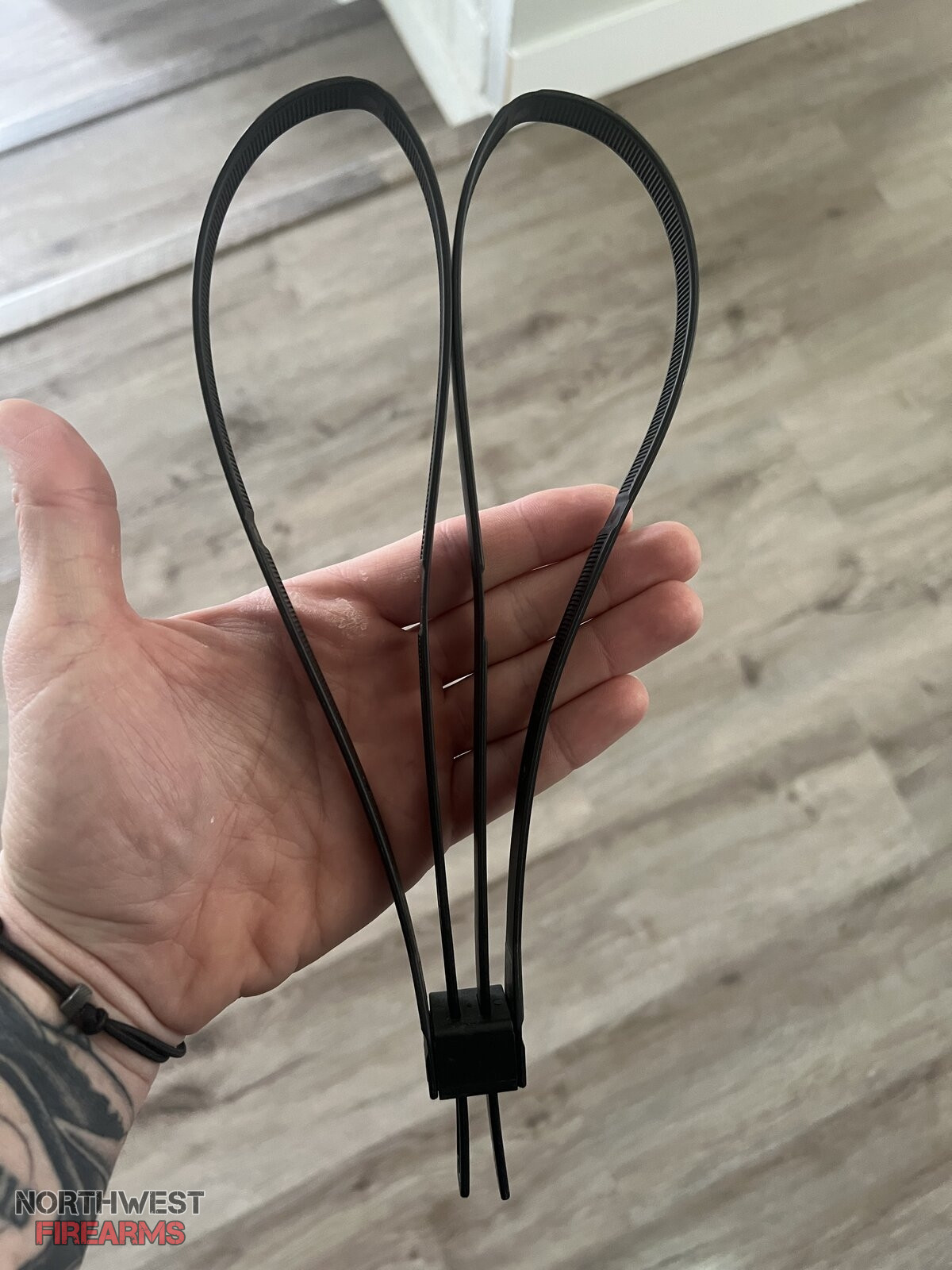

Do police use other types of restraints, like large zip ties?
In another thread we discussed how the trigger area of plastic holsters is much larger if the gun has a WML, I recall a screenshot of an incidence holster proving this. Any officers here dont take this the wrong way but its been my observation that just because a particular item is chosen by a professional authority (this included military use) does not mean its a good or safe option, many times the decision makers are wrongly biased or just simply not gun enthusiast naturally (outside of their job). If I recall, any holster that doesn't fully protect the trigger area would be rejected in any IDPA match.
Over the years here a common question often asked is what holster should I get, and many times some of the suggestions I reel back at with glaring trigger gaps... often recommended by otherwise very experienced individuals. Often from higher end holster companies with a price to match.
In short, the holster is a critical component in this mystery.
Yea they have flexi cuffs but those aren't in common use on patrol. Although some officers carry them. They are more intended to for mass apprehensions. Basically big zip ties.
