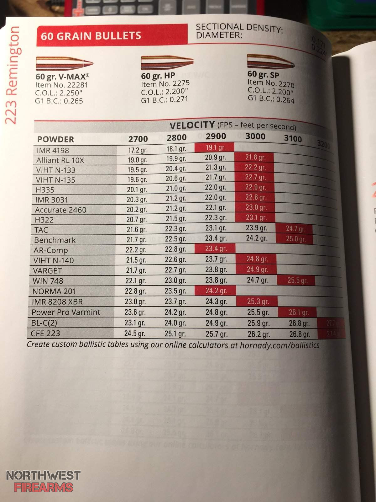

Here. Actual information you requested.
27.4gr is the maximum published on the far right.
Taken from the Hornady #10 book.
Thought he was looking for the Sierra 60gr, though that should get him close as long as he starts on the low side.
Considering Sierra's has a BC of .246 vs the .271 of Hornady's.... pretty darn close powder load wise. Anyone who would do a ladder anyway would find the sweet spot.
So the Hornady is a little sleeker.... overall it's negligible.
