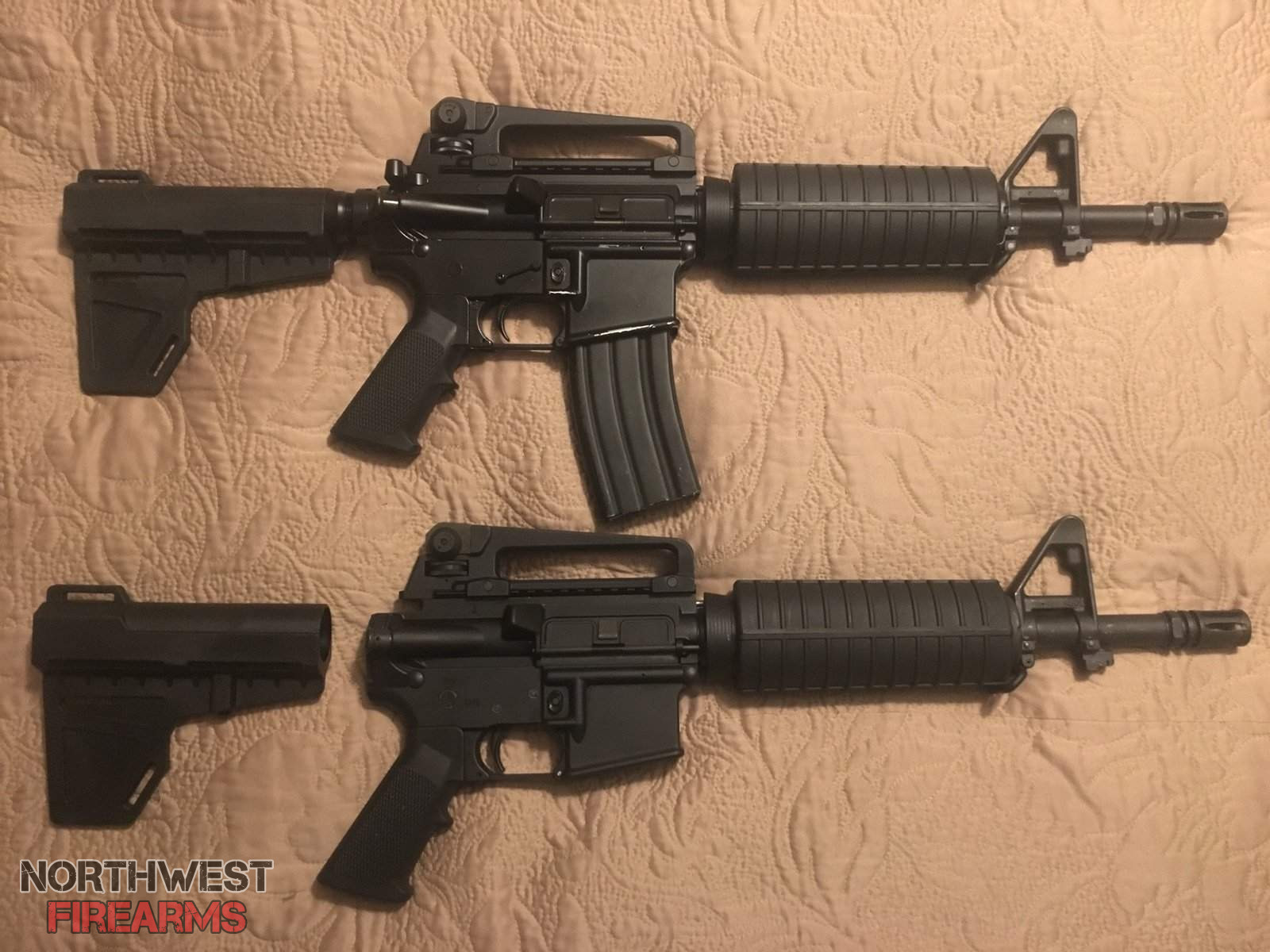

11.5” AR “pistols” that I’ve carved from 80%ers (the bottom one is now completed)... they’re awesome shooters.

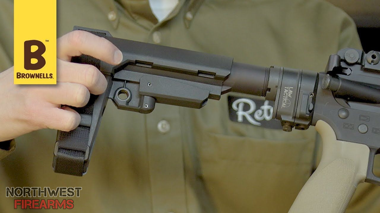

Is the arm brace in that pic adjustable for length?
It is adjustable, the buffer-tube has a multiple divots in it along the bottom, but you need an Allen wrench to work the set-screw to make any adjustments.
