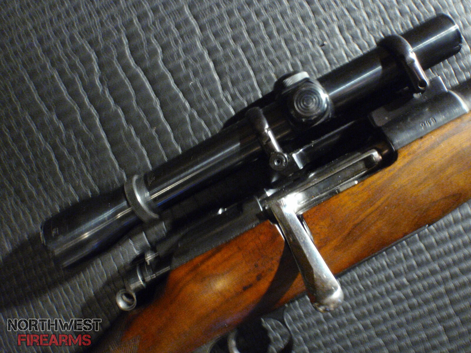

I had a Hurricane scope on a Parker Hale .270 years ago, but it must have been a newer model, as it had conventional turrets/adjustments. Looked like this:
I'd be very interested in seeing a picture of those mounts. Here's Leupold's version of adjustable mounts ("Adjusto mount") from the '50's (in this case, mounted on a Mannlicher, with a 2.5x Weaver: conventional turret adjustment). This mount operates on cone screws, much as a Conetrol or S & K, and Leupold's early scopes like the Pioneer had no internal adjustments.
In a scenario like this, a fully adjustable mount allows for better centering of the reticle within in the travel range of the scope's adjustments (for a better quality of sight picture).
It was common then to use adjustable mounts with an adjustable scope. Early scopes had a moving reticle in the view. It could end up way off center. Later scopes used a moving image, with constantly centered reticle. This was a big advertising feature until it became normal for all scopes.
