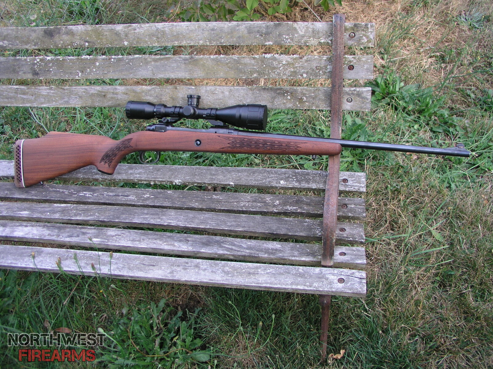

Here's the Savage with the scope it came with. Don't even remember what it was. but there was no bolt handle interference.
