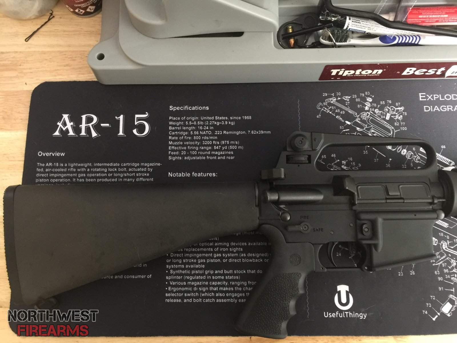

So I have an RRA A2 Carbine upper and just added an A2 stock to the rifle. Interested in adding a retro carbine handguard set like these (or similar):
REPRODUCTION M16 CARBINE COMMANDO HANDGUARD SETS
Any experience or information on adding these is appreciated. Will it fit without modification? It appears I will need one of these:
AR15/M16 .625" triangle hand guard cap
Not sure how hard it is to install?
Also considering having barrel cut and then a proper flash hider pin and welded.
Any suggestions or information is MUCH appreciated.
I will post some pictures of what I currently have.
Thank you
MilitantBEEMER
