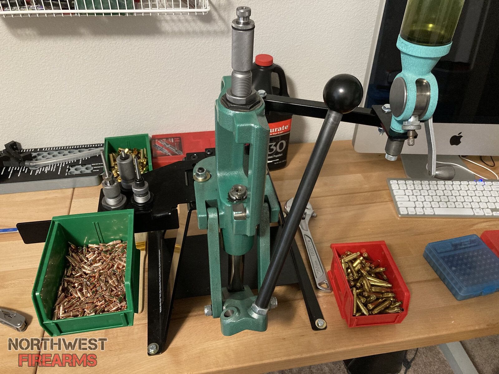

Im actually tempted to get that since Im taller. Not certain yet what my workbench needs... but bookmarked that.
Something about the mounts steadies the press more better good. I have no idea how, but they work. When I built my prior load bench, it was double thick 3/4 plywood with 2x4 supports. I mounted the press directly to this. It flexed with all that.
After we moved I bought some premade tables to use as a bench and bought the Inline mounts. They are rock solid.
Just an opinion, but I'd highly recommend them. The accessories available at inline make things easier to utilize the press as well.
I run a 4x4 leading edge, 2x4 on edge against the wall and 3/4" OSB as a surface.
I also run 4x4's from leading edge to wall where the press mounts. Flex? 1/8" or less at press.
I can't stand a moving press.
