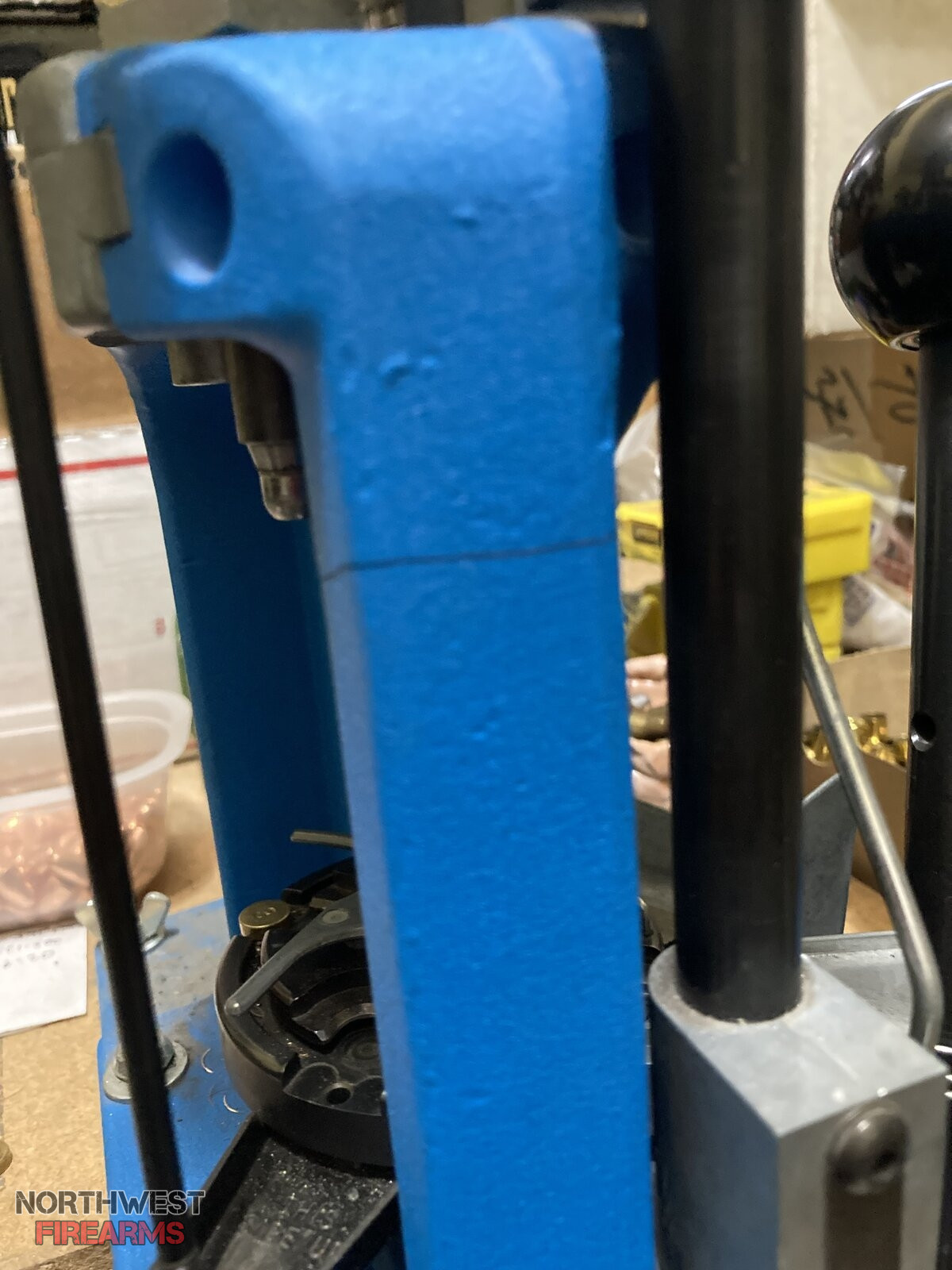

I'm curious? What parts do you break on a 550?
The frame itself!
You probably could've duct taped that bad boy and still be making rounds.
:s0140:
Actually, I did make quite a few rounds without the duct tape, but I was puzzled why my overall length suddenly became erratic. Finally figured out why. (Checking the frame for cracks was not the first place I looked..)
