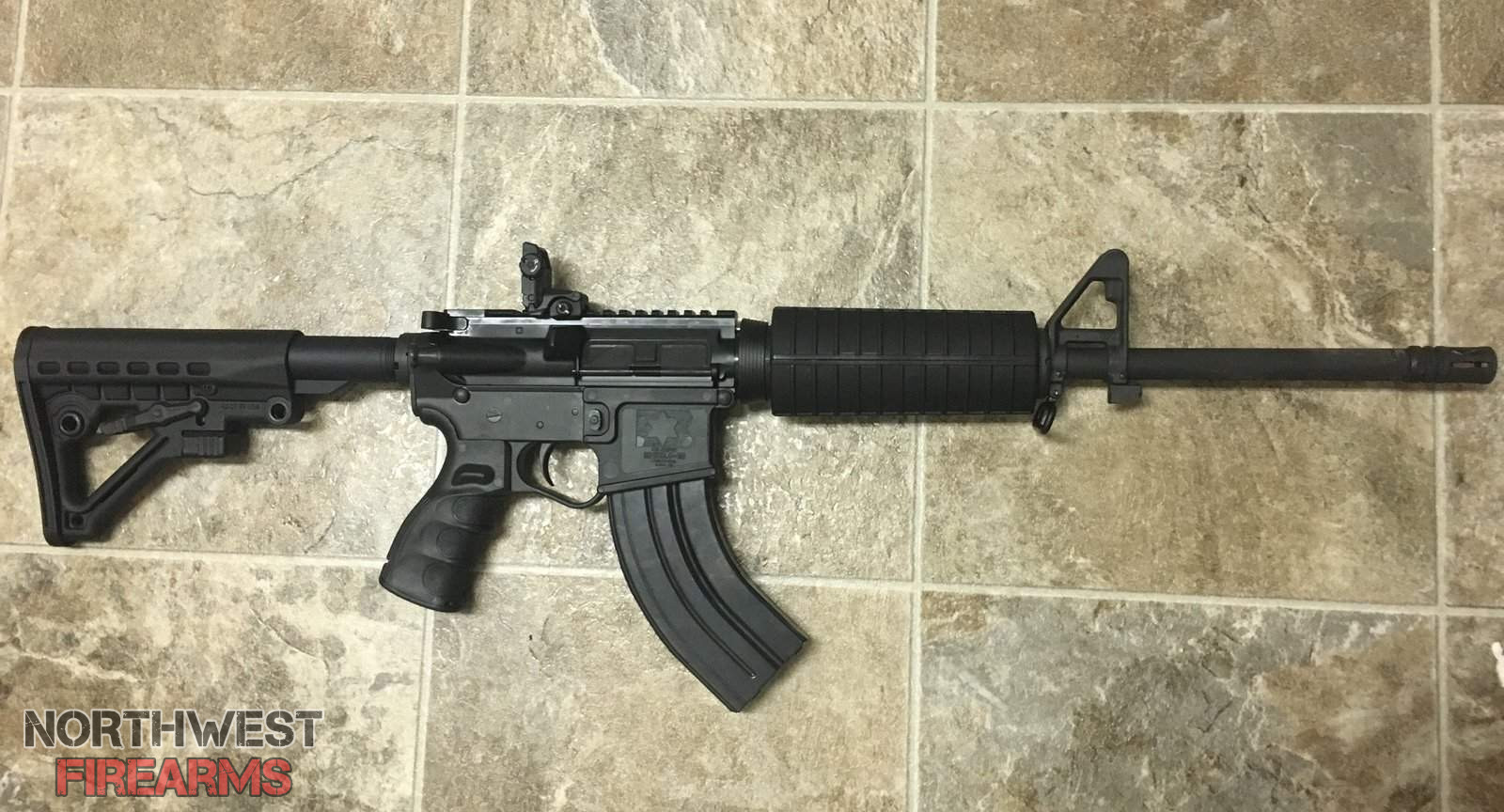

There's a handful of options out there for polymer lowers. Some of these manufacturers talk a pretty good game, even claiming that their plastic lowers are not only cheaper than aluminum but actually better, too. And the online reviews for some models like the Omega Arms E3 Gen 2 seem to be mostly very positive. Just wondering if anyone has had any of them long term and can speak to how well they hold up after thousands of rounds?
I bought one a little bit ago to play around with a 7.62x39 upper and have only about 140 rounds through it so far. The only issue so far is the hammer spring isn't strong enough to set off Tulammo primers some of the time (but seems to work fine with the other brands I've tried (Wolf, Brown Bear, etc). I ended up replacing it with a heavier spring which seems to have fixed the issue entirely. It's worth noting this issue is common to AR's when using x39 uppers, and not unique to polymer. The stock is a little chintzy and I may replace that as well. Guess only time will tell if this was a heck of a deal or a poor choice at any price.

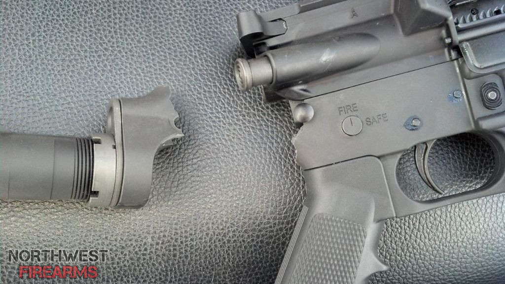

The only polymer lower I'd consider is the GWACS Cav-15, formally CavArms. Polymer receivers cut to standard forged lower dimensions are prone to crack where the receiver extension threads into the lower, there is simply not enough polymer mass to prevent it. They go into it here in this video just prior to the 2 minute mark.

Poly lowers for an AR are ok if you want a toy (seriously) and only plan to bench shoot with it. As stated above, the rear of the poly receivers are TERRIBLY weak where the buffer tube threads into.
