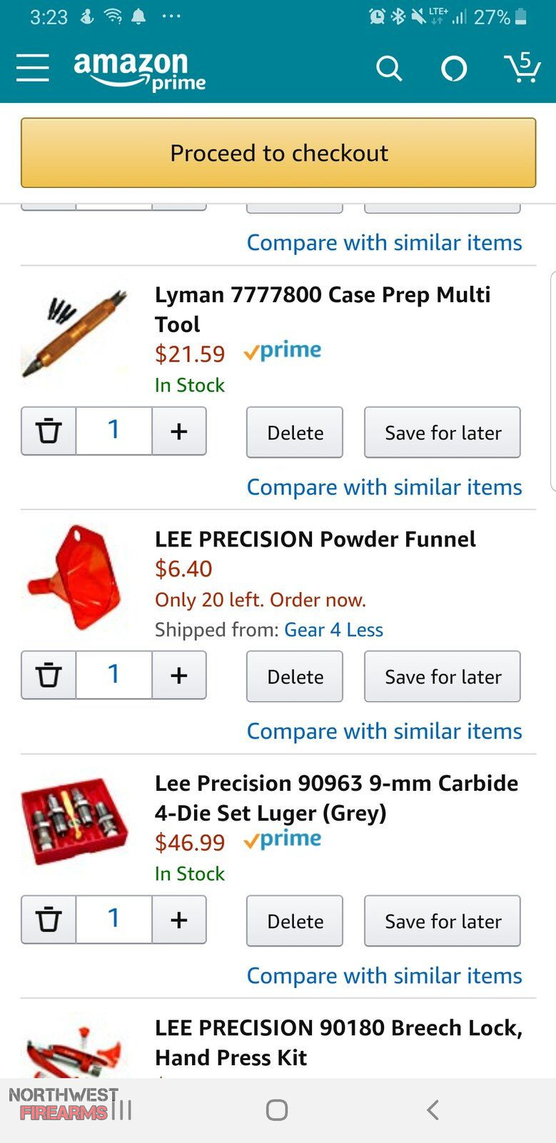

Screenshot_20191121-152344_Amazon Shopping.jpg plus a cheap scale is there anything else unfortunately i dont have enough room for the full set up or id just get a progressive

Hey guys im getting ready for black friday and id like to start reloading im curious to what all i need from the research ive done the list i have to order is
Lee 9mm 3 piece carbide set
The lee hand press
Lee hand prime
A scale
A de primer and a trimmer
Calipers
Is there anything else i plan on getting more kits just want to start with 9mm amd work up
Ps ive been reading the lee loader book just dont have a place to ask questions
A scale is a pretty handy and important reloading tool to have. I'll say it again, even the least expensive Lee scale is better than none. People who reload using progressive equipment also need a scale. The Lee dippers are better than absolutely nothing but not as accurate as a scale.

View attachment 634764 plus a cheap scale is there anything else unfortunately i dont have enough room for the full set up or id just get a progressive

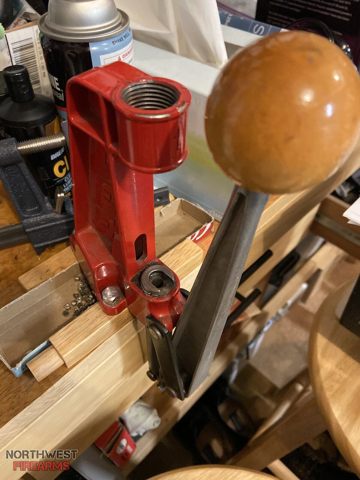

Your making this way too complicated. Bag that hand press and get a real press. In a kit, then your not going in piece meal. Personally I went with the RCBS Rock Chucker Supreme Master Kit. RCBS Rock Chucker Supreme Master Reloading Kit with M500 Scale The Lee kit looks much lesser built. Ask around here how old some of these guys RCBS presses are? Lee?
I don't see how a bushing set up for dies is any advantage in a single stage press. Dies have threads, they screw into the press and stop at the lock ring. ? If your on a progressive then having 3-4 dies in a tool head IS an advantage. Priming on the press with those little tubes looks like a PIA. I never tried it? But I just can't see how it's better than a hand primer. A hand primer will give a better feel and take less time to set up and operate.

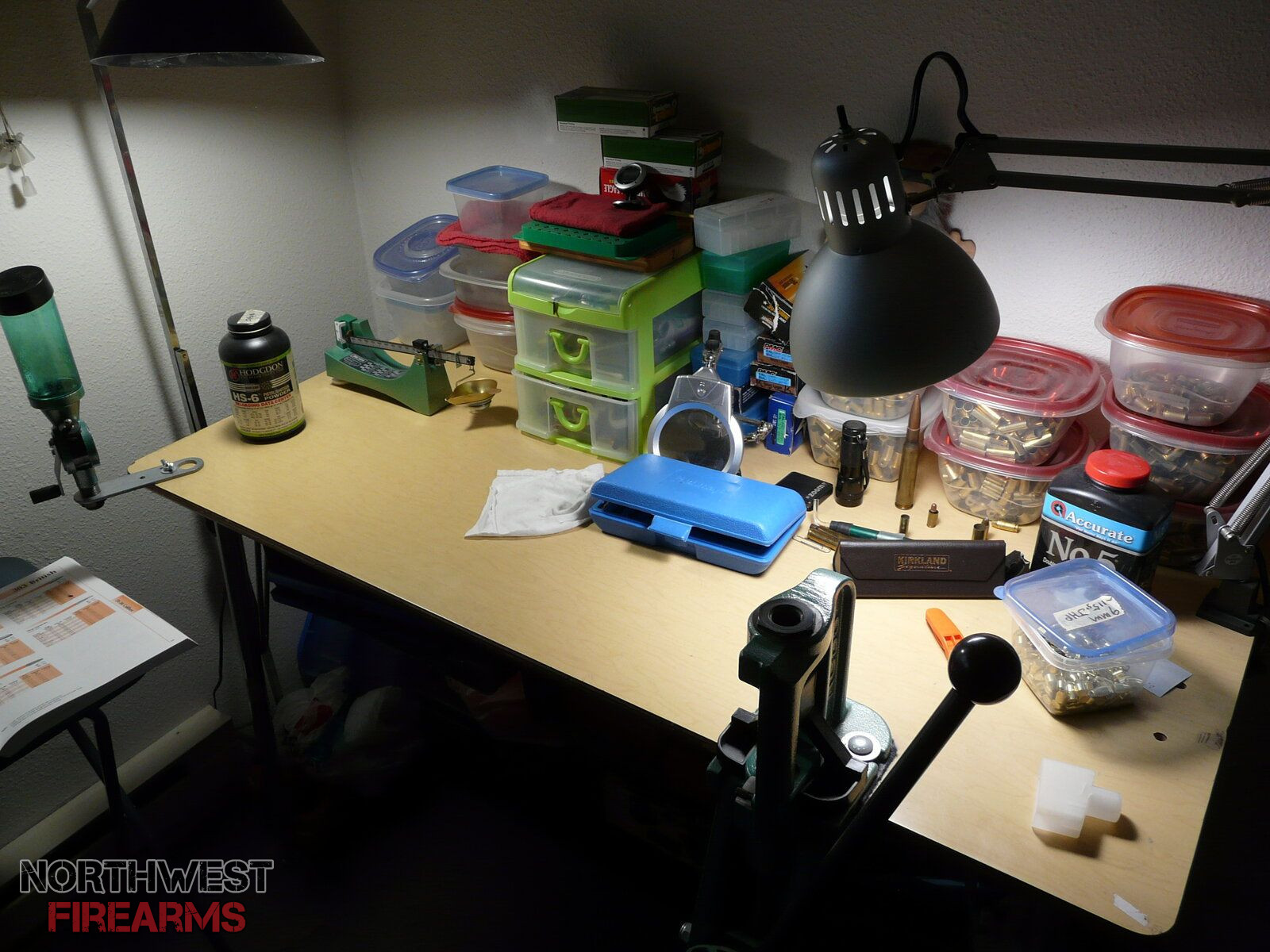

Plus i live in in an apartment so im not worried about speed i plan on doing 308 450 bush and 223 after 9mm if i like it or what would be an easy caliber to start
So? I live in a 974 square foot house. All it takes is a small solid table in a corner. ;)
That table is 4' X 2'
And before people jump on me that TWO kinds of powder on the bench are a supreme NO-NO only one is open and the AA5 is getting ready to be put up for sale. Besides, there is never an open/being used/ready to be used powder on that side of the table. Any bottle to be used would ALWAYS be near the powder dispenser.
