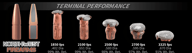

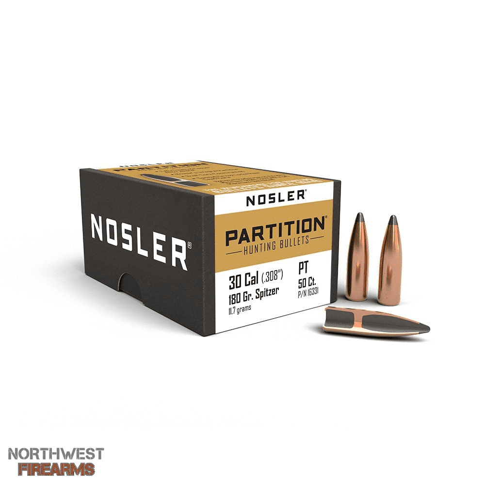

They seem to be the equivalent of each other by design. If I just look at the cross section picture of each is seems the Swift has a thicker copper jacket which my guess would offer slightly more penetration, where the Nosler Partition has a more pointed tip which might make it slightly more accurate. Just a guess.
Any preferences, opinions or real world experiences between the two? What would you choose to hunt big game with?
1611613112580.png ...
(Swift)
I have always used Nosler, but both bullets would serve you well.
If you go with Nosler the Accubond is a great bullet too.
Depending on what you are asking the bullet to do even the Nosler BT works well for a little lower cost.
Think of swift a frames as a bonded partition because that is the basic difference. I believe partitions tend to kill a bit faster as the front end comes apart easier and imparts shock and awe while the base drives on usually all the way through except on rakish shots. A frames hold together better and will generally penetrate very deeply with a textbook mushroom and very high weight retention. I think of partitions as good for everything but I would probably hedge my bet and use swifts for mammals larger than elk especially if they have claws. I shot a 1000 # moose stern to stem with a 175 gr swift a-frame out of a 7mag and performance was impressive. He stood there for a moment and then just tipped over. I recovered bullet just under hide of chest and it weighed within 10gr of original weight.

Your moose experience correlates nicely with what reviews Im reading online, basically while both brand have great penetration the Swift has a bit more than the Nosler.

Partitions open up fairly quick and the couple I've recovered often had a bulge in the lower half. They seem to do more damage internally, but don't penetrate as well as an A-Frame (not a bad thing, especially on deer or elk).

The 100gr TTSX will retain 99% of its weight and is a wicked bullet when pushed fast. A partition will retain around 60%. That means a 120gr bullet then weighs 72gr. Monolithics like Barnes outperform their weight by a good margin.
