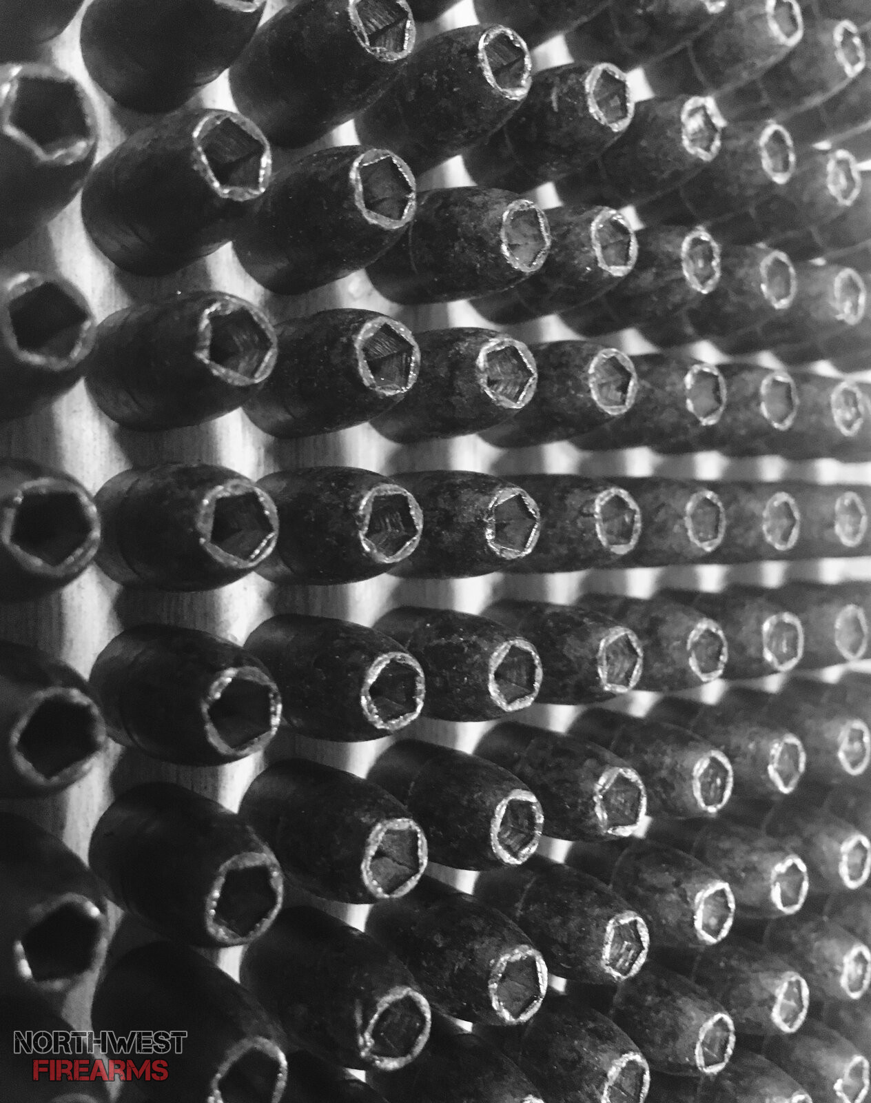

I'm thinking of a 6 cavity steel target mold. Most of my molds are aluminum. Some get sticky. That's probably me. But if you know of a steel 6 cavity target please let me know! I've gotten into powder coating. Pretty neat process. I made a stand out of 9mm cases that I put the rounds in tip down so only the contact portions of the round get coated. Seems to work pretty nice.

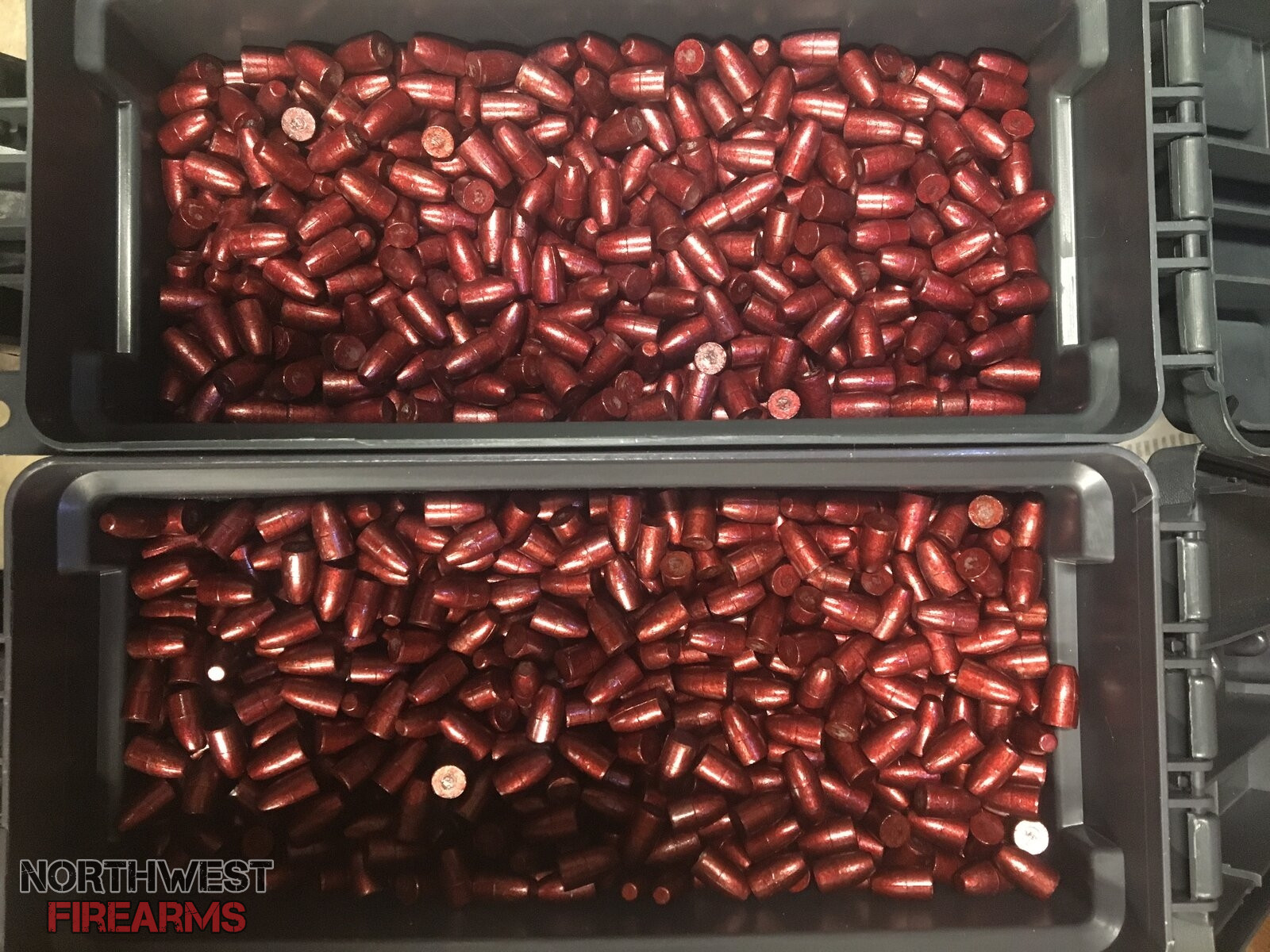

I've got that mp mold in both a brass 4 hole hollow point mold and a pair of 8 hole aluminum molds for production and all three produce a great bullet which run great in my competition guns.
