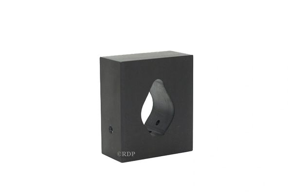

It's beyond that, I have a Pelican 1660 full of AR specific tools and I wouldn't do it. Installing an FSB to a new barrel requires a very specific and often very expensive jig to do the job right.
Not to Hijack the thread, @titsonritz , completely agree. I was not even thinking about sight alignment -- I was just thinking of fubar'd stuff I've seen when people tried to pin them in place -- not just on rifles. The telltale sign is the tracks of the drill bit wandering across a curved surface, keyways that have been hammered on, etc.
