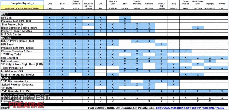

Here is "The Chart" from years gone by, note the number issues related to the FSB common with lower tier manufacturers...
"The Chart" was the source of the beginning of what is now known as Butt Soreness if your rifle landed on the wrong side of The Chart.
IIRC, the Rock River guys were the biggest crybabies.
