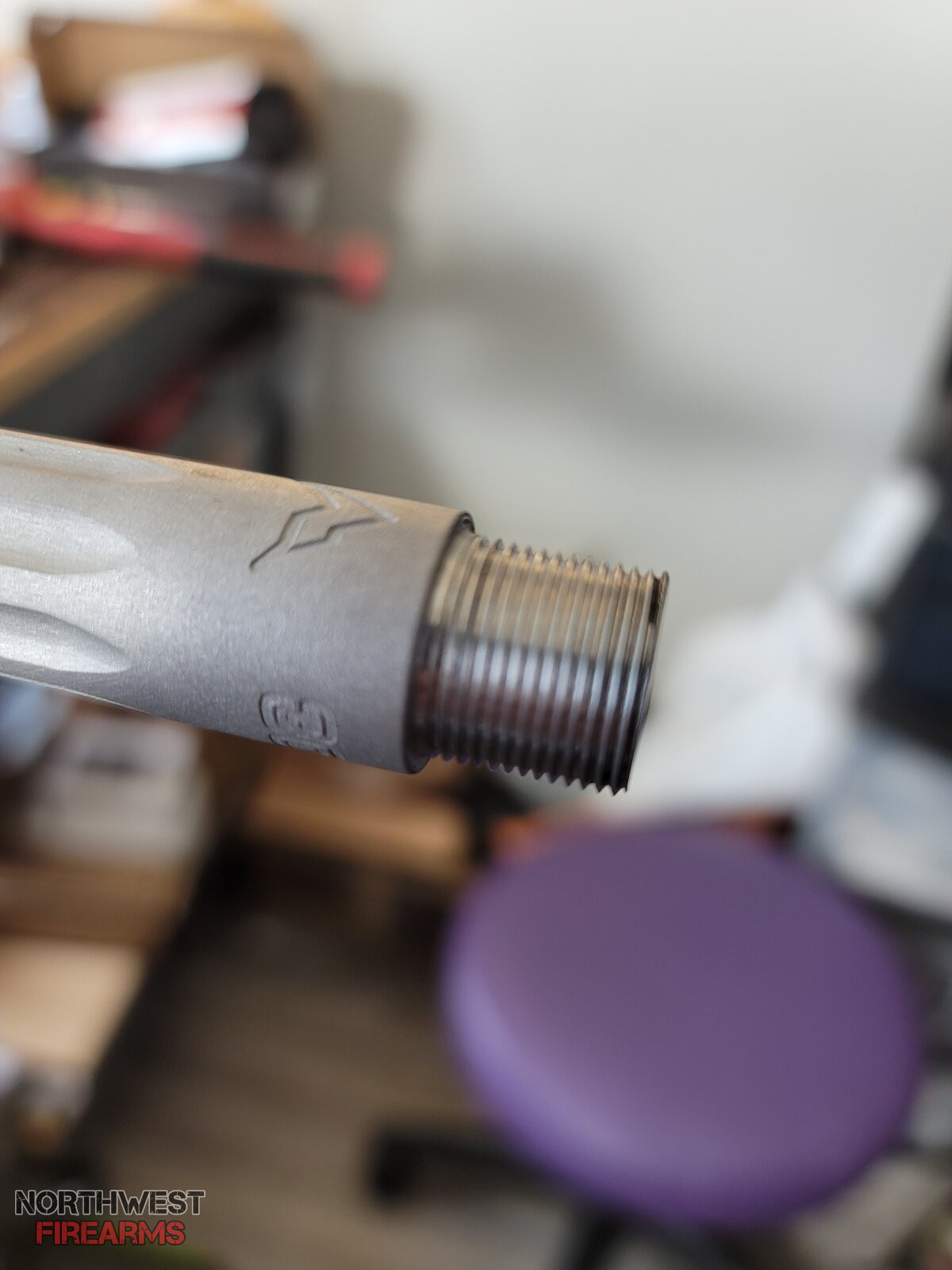

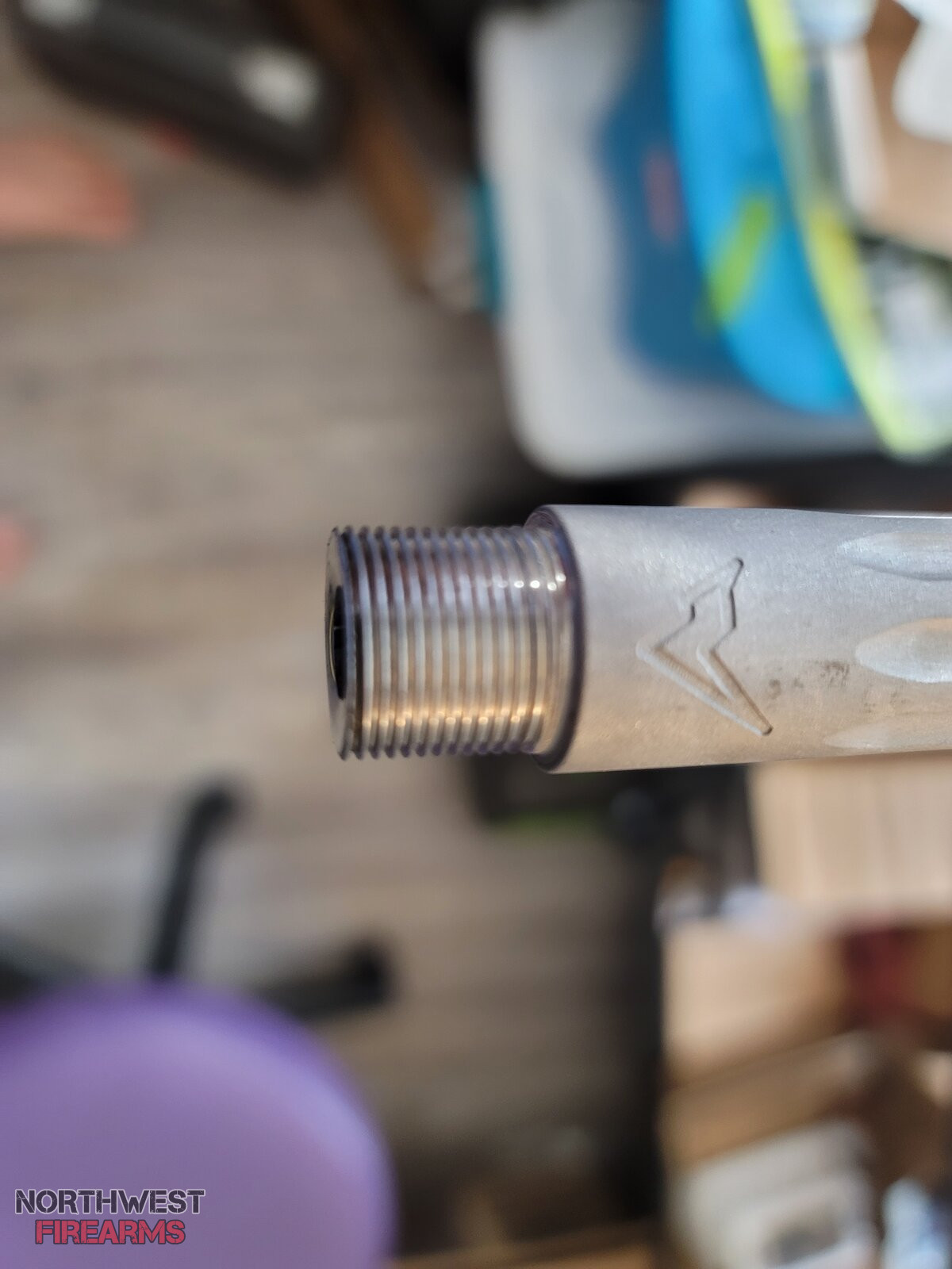

Both are definitely supposed to be 5/8-24. And this is actually the second barrel rainier sent me due to the first looking used upon arrival. Another thing I noticed on this one is that they didn't soften the end of the threads after cutting. Just a sharp edge.
Sound like a poor threading job to me, threads are classed by tolerance, not sure what a silencer should be, but I wouldn't expect much, if any, wobble. And the start definitely should NOT be a sharp edge. I'd be contacting the manufacturer.

I'm inclined to put Rainer on my "no buy" list after that picture

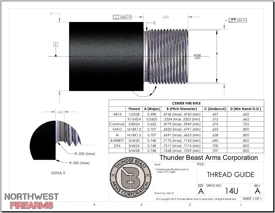

It looks like those muzzle threads do not have a relief or undercut. You may not be torqueing against the shoulder properly. They make a spacer to address this. BRgon5q.jpg

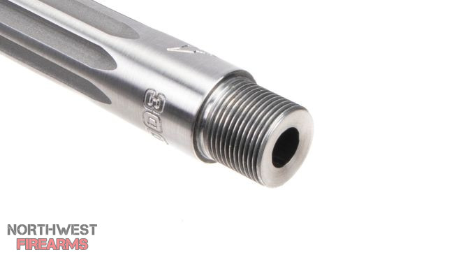

For what that barrel costs, that's a pretty ugly looking front end. Especially compared to the picture from their own website
I would send that back in a heartbeat. No reason to risk your can on those crappy looking threads. Hard to tell from the pic but it doesn't look like there is any kind of a crown either.
