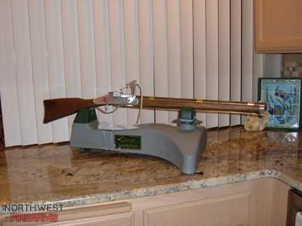

Andy,
I made a clip out of left over brass from the barrel bands and filed a notch in it.:D
It fits tightly over the rear sight, but will slide, giving me windage. That should do the trick.:)
Also, the 25 plastic screw top vials I ordered came in and they are now all filled with 50gr. of FFG.:D
Lets Rock and Roll !!! :eek:
Can't stop tinkering..:rolleyes:
Added a ram rod...Under the forearm, as I didn't want to cut another groove in the stock.o_O
Used a couple of aluminum spacers for the ferrells as I have a box full of them. I double
holed them and attached them with a couple of copper boat nails.
* Note to self: Next time use a clamp to hold things in the V-block when drilling. It saves on
fingers..:eek:

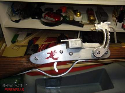

I looked up Chinese characters on the WEB and that one says, "Fire Dragon".
I traced the glyph and stippled it with my etching pen, then I covered it with
some red touch up paint.
Just more tinkering...:)

Here is the first bench session. The video says it's too large to load.:mad:
It's OK, for patched marbles out of a smoothbore, at 15 yards. :rolleyes:
You don't need a spotting scope.:)
(50gr. of 2F) I was having a lot of ignition failures with 2F in the pan. Next time out I'll try 3F, or 4F.:(
37-first-4f-target-jpg.8995
Used 4F powder in the pan Thursday. Reliability was 98%, two shots were slow to ignite. Accuracy was a lot better too. Progressive Bifocals started causing trouble off of the bench at 25 yards and things were getting fuzzy. I think I'll buy a cheap pair of single vision. Either that, or quit drinking coffee before I shoot. It's looking better.:)
