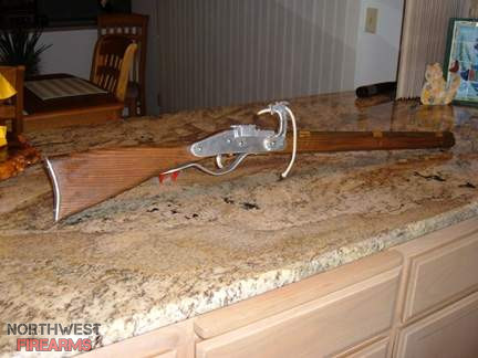

All I need now is a Muzzle Brake, Laser and a 30 rnd match holder...:eek::eek::eek:
You've done a Truly Outstanding Job of Creating a of Recreating a Wonderful Old Timey Musket and it can only be Improved upon by some Really Nice Stock work! :):):)

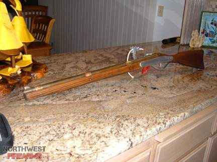

Thanks KKG, but i'm just fumbling my way along, mostly using whatever materials I find in my shop. All of the hardware except the barrel is aluminum, (it's what I had) and I'm afraid my wood work would give a termite indigestion.:eek:
For an, "AR person", it does represent an extreme swing to the other end of the spectrum. I think the challenge is what's keeping me going. I want to see the bloody thing work.:p

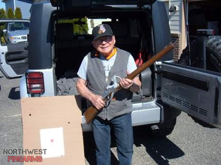

Here it is and it works!!! Who says I flinched?:D
My first off hand, 15 yard "Group." 50gr. of FFG.:(
Ctr.>Ctr., about 12":p
If it had been an elephant....I would have probably gotten stepped on.:eek:

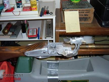

Wah !!! It sure gets dirty in a hurry.:rolleyes:

First thing I noticed was the rear sight notch is way, too wide.:(
If I narrow the notch on the right side, it should be the same as moving the
sight and the strike of the bullet to the left. Or, am I backwards on that. o_O
OK. then, narrowing the notch on the left is the same as moving the sight right.:rolleyes:
3 out of four of the hits were on the right side of the target. I hate to think of unsoldering
the sight and moving it, but I may have to if just narrowing it doesn't work.:(
