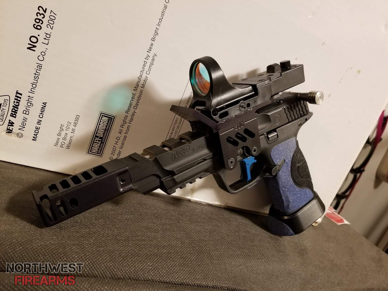

But gonna hit a 173 power factor for my Major 9mm open gun.
Just shows how useful HS-6 is.View attachment 432679
This is why I like the idea of a slower burn rate compared to Titegroup. I tend to think it should help lessen possible pressure spikes. And that load ranges are greater than faster powders. I still think you may be looking at compressed loads though?
