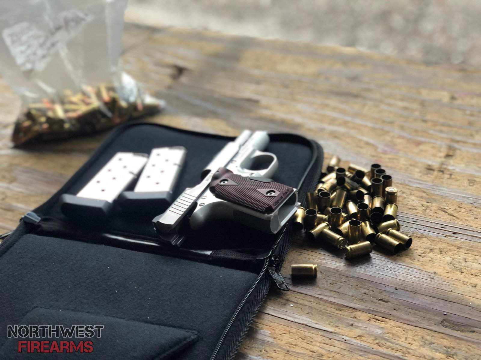

Ya'll have a simple recipe for low power 9mm?
115, 124 or 147 gr?
Picked up a Kimber Micro 9 today and would like to not eat the web off my thumb before it has a chance to callous up. My normal loads I have for the XD9 Mod.2 are perfect for the heavier gun but brutal in this smaller one.
Looking for suggestions on some commonly available powders and more specifically the bullet weight mixed with the powder type. I hope and plan to use CFE-Pistol but am not opposed to picking up a pound or so of another powder that meters well and is fluffy for practice rounds. While I know I can't eliminate recoil (duh), just looking for a suggestion and any personal starting locations.
Thank you in advance.
-Dyjital
