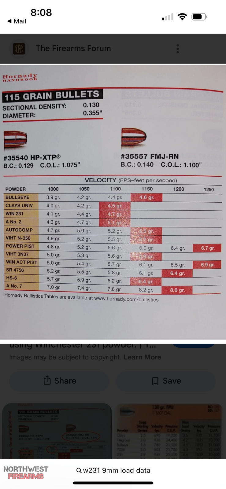

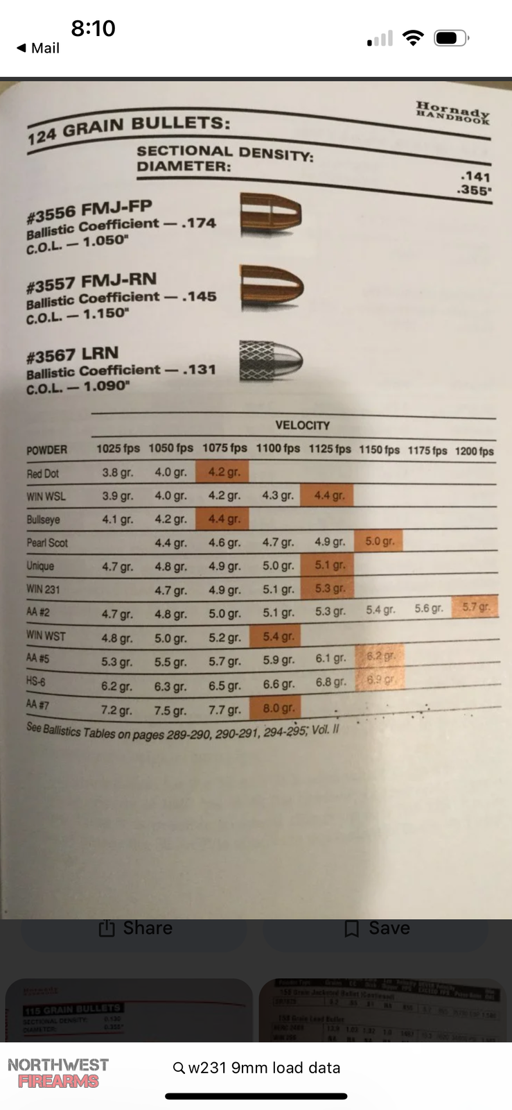

Here's what Hornady says. If you don't have a manual, I'd highly recommend getting one.
I'm using 4.6 grains and getting 1050 FPS
Not sure where the max is but I'm pretty sure I have lots of room

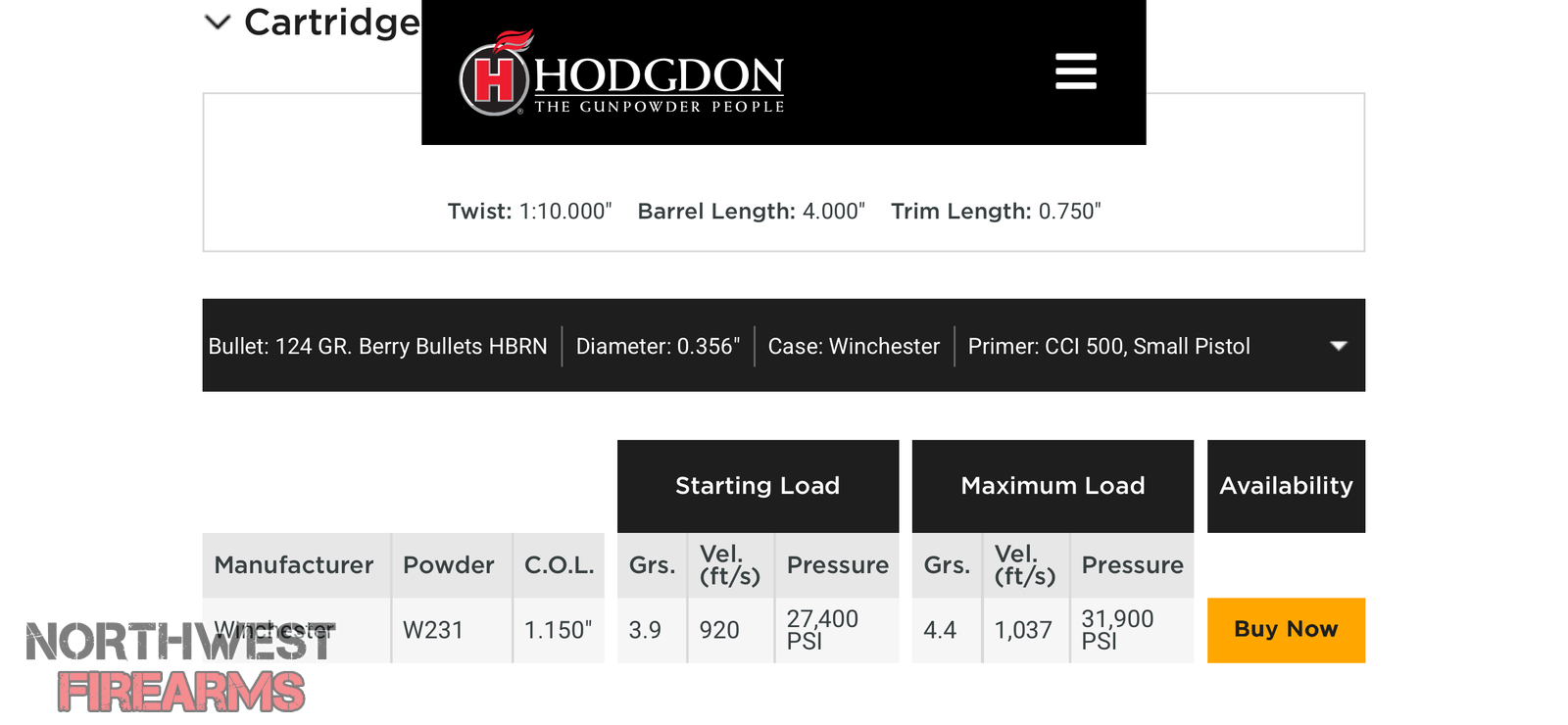

FYI, looking at the 2025 Hodgdon manual for 125 gr lead (they do not have 124 gr lead with 231 powder, their max is 4.4 grains, so you are .2 above their max already. Although it sounds like it's been working for you for 65,000 rounds. Notice in @DizzyJ 's posted Hornady manuals how the max has been downgraded from 5.3 to 4.7.
I attribute lower maximum loads in manuals as time passes to two factors: attorneys and better load testing by the companies. Not saying you are doing anything wrong (I too have loads that I've been using for years that were blessed by 1980s manuals that are now over max), just wanted to throw it out there.

My electronic version of 11th Hornady manual doesn't list W231 or HP38 9mm 124, for some reason.
DizzyJ's picture of whatever edition Hornady shows W231 with 4.7 minimum and 5.3 max with a lead bullet at a stubby 1.090" length. .
The current Hodgdon reloading data site says 4.4 gr W231 with a Berry's bullet at 1.150" is Max, listed at 31,900 PSI for 1,037 fps, or 128 PF.
Dang, a lot of discrepancy there, .9 of a grain.
I load my 9mm to be ~130 PF, so that none of the slowest rounds dip below 125 PF, but I load 147s and haven't used W231 in 15-20 yrs. Still, I am surprised that max data with a 124 gr lead bullet is right at PF.
