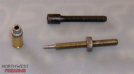

This is how I seat soft hollow points in 9mm. To keep from deforming the bullets, I found some threaded rod the same size as the bullet seater and turned the tip to the same demention as the mold insert. Pushing down from the inside doesn't tend to flatten the bullet. HP Seating Tool-2.jpg HP Seating Tool-1.jpg
