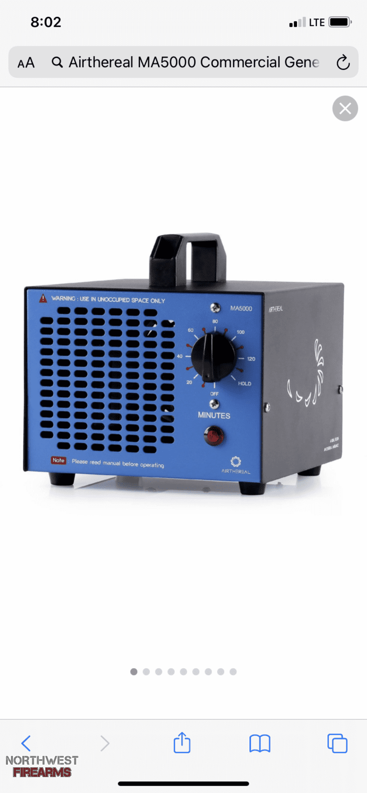

It's similar to this unit. @The Heretic

Ozone it.
Heck I've been anodizing titanium and the bubbles are reminding me of what an ozone generator smells like.

I will ozone after work.

Very distinct smells that often stays with you. We have an ozone machine that we use at work (real property investments). With using said machine, is there any harm to whatever is in the safe? Firearms? Etc?
Lightning strikes produce ozone, as well as nitrogen oxide. Maybe leave the safe open on a golf course and let the lightning do the job.
