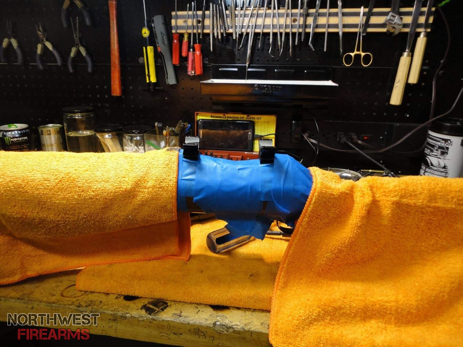

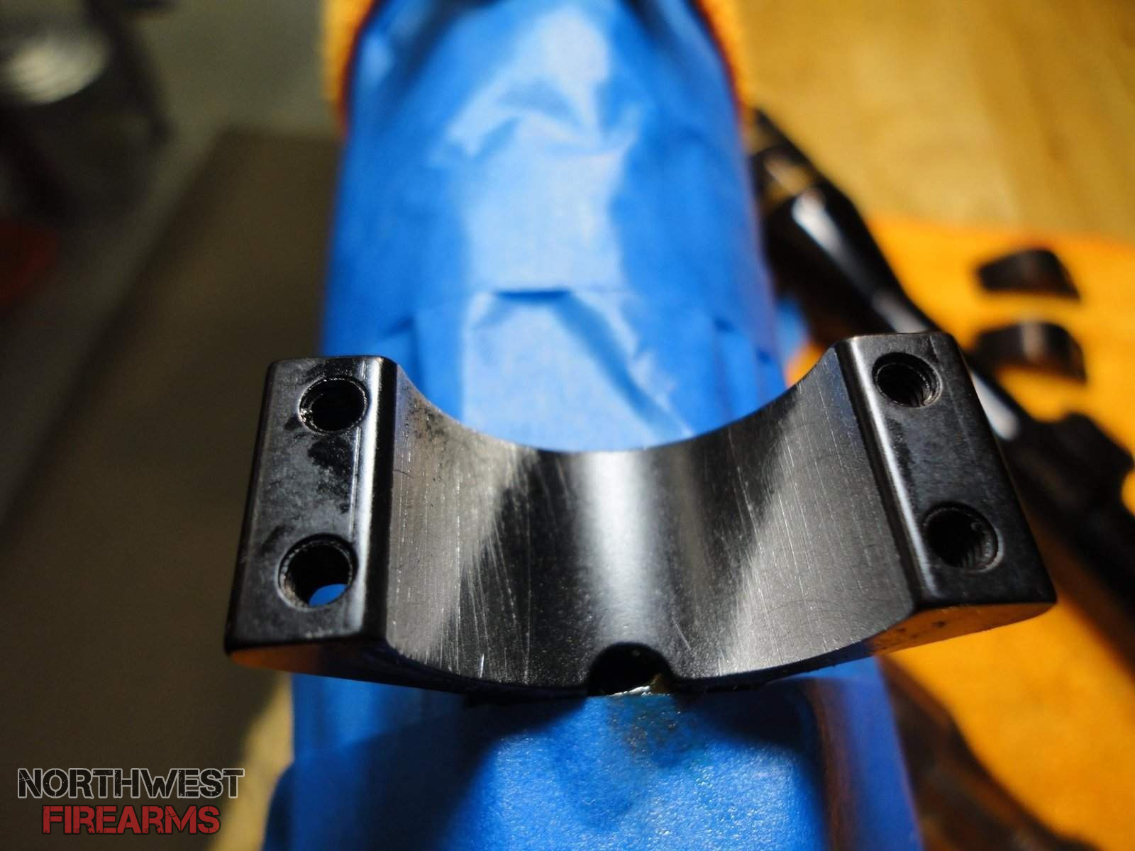

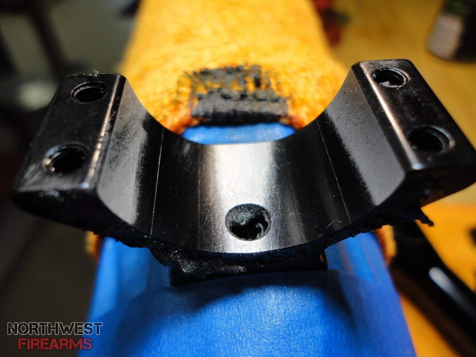

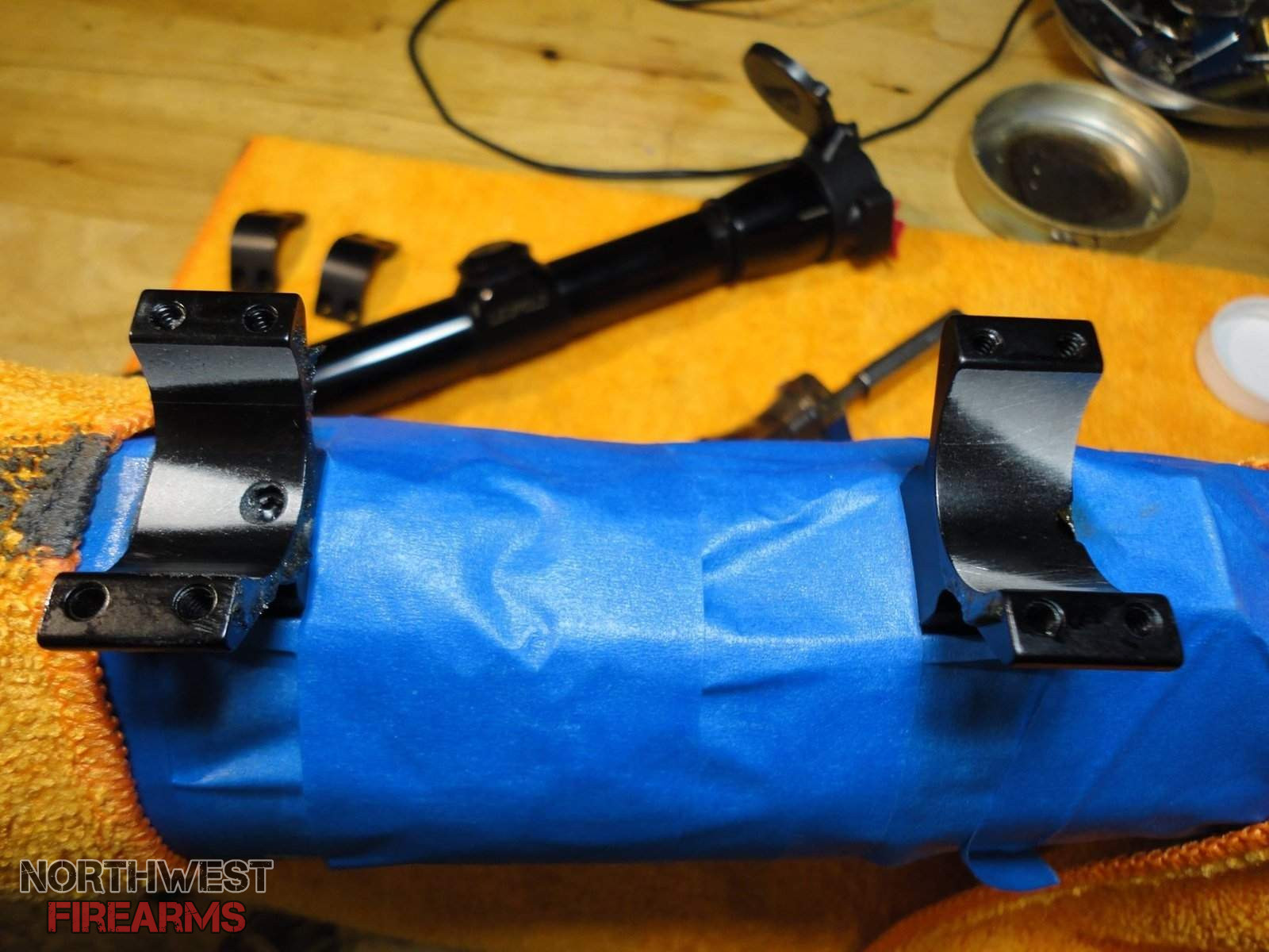

Always even on cheaper ring sets. A friend of mine just shared these today.
And yes you can lap anodized rings. You would need to remove allot (.010+) to get thru the ano.

The two reasons for checking alignment and lapping in rings is to correct slight misalignment and provide full contact surface area to hold scope more securely. I have seen some pretty bad cases of scope ring misalignment that couldn't be lapped out. Buying quality scopes and rings definitely up the odds of not having problems but even a good set of rings on a quality rifle can be slightly misaligned and put the scope in tension. A good scope usually will handle this but a cheaper one can be compromised. At the very least, a good scope in rings out of alignment that have not been lapped to provide full contact stands the chance of slipping in the rings and shifting zero. I check alignment every time and lap accordingly and highly recommend serious shooters and hunters do the same. Here is the alignment/lapping kit I use, it does 1" and 30mm tubes.

misaligned rings can cause you scope tube to bend. changing the optical center, as well as possibly damaging your scope tube or internal parts. plus you want full contact on your scope to ring surfaces. also measure ring gap upper half to lower half,with feeler gauges and make them all equal, and torque ring mounting hardware.
