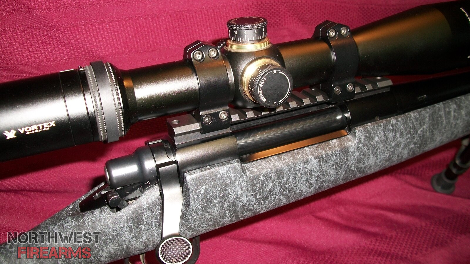

Here is a picture example of my 30-06. Remington 700 SCR II Bone Collector, Limited Edition SS barreled action Trinite from factory. H&S Precision.

Very nice job on the rail bedding, cant even tell...

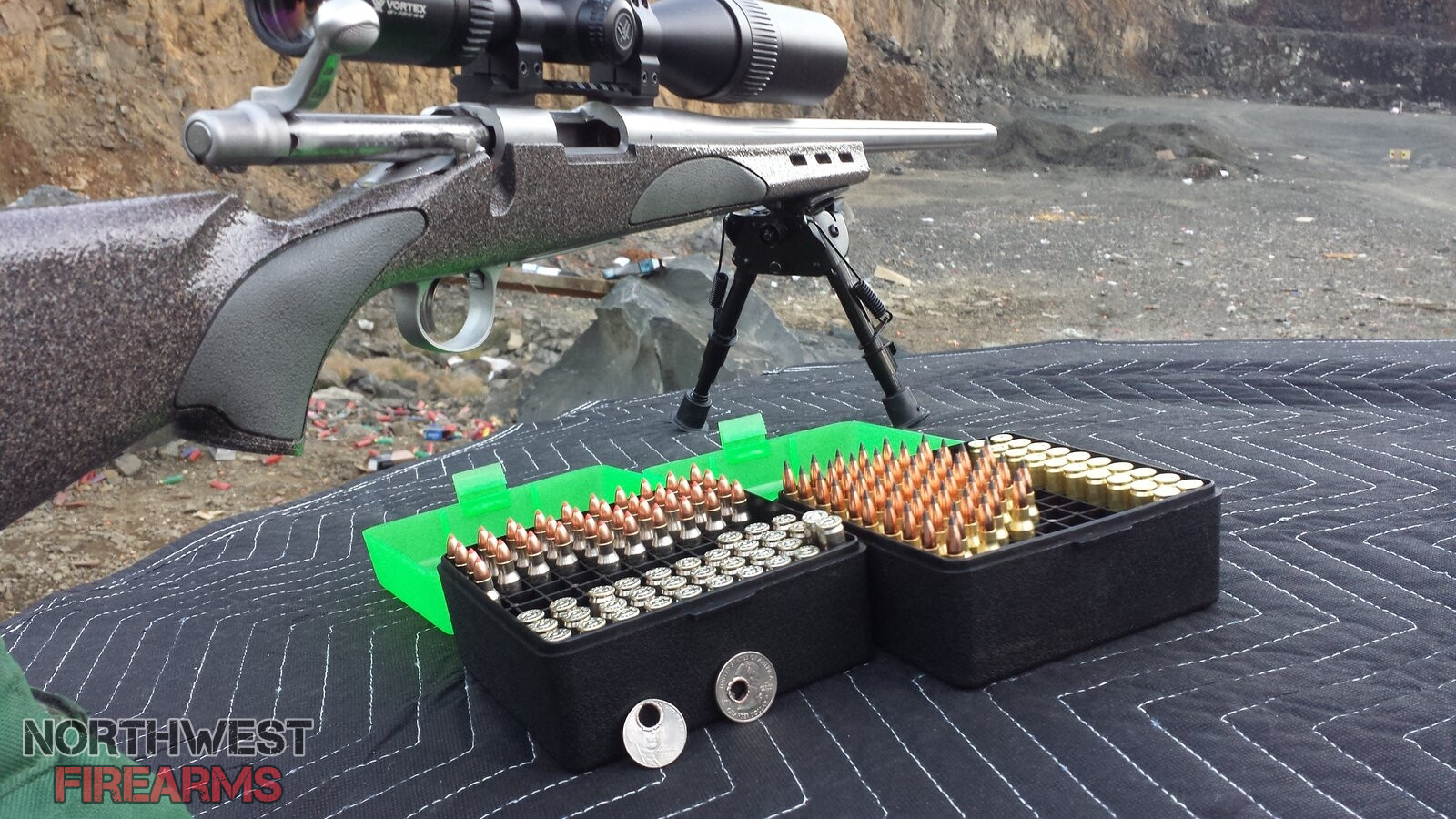

What I can confirm is that I took an off the shelf Remington 700 -- .223 heavy that shot about 3 to 4 MOA. After bedding and load development it now shoots 1/2 MOA. It shoots holes through dimes at 200 yards.
I have pictures to prove it if I can find them, I will post the documentary process of bedding, and the targets results afterwards.
214 yards.
