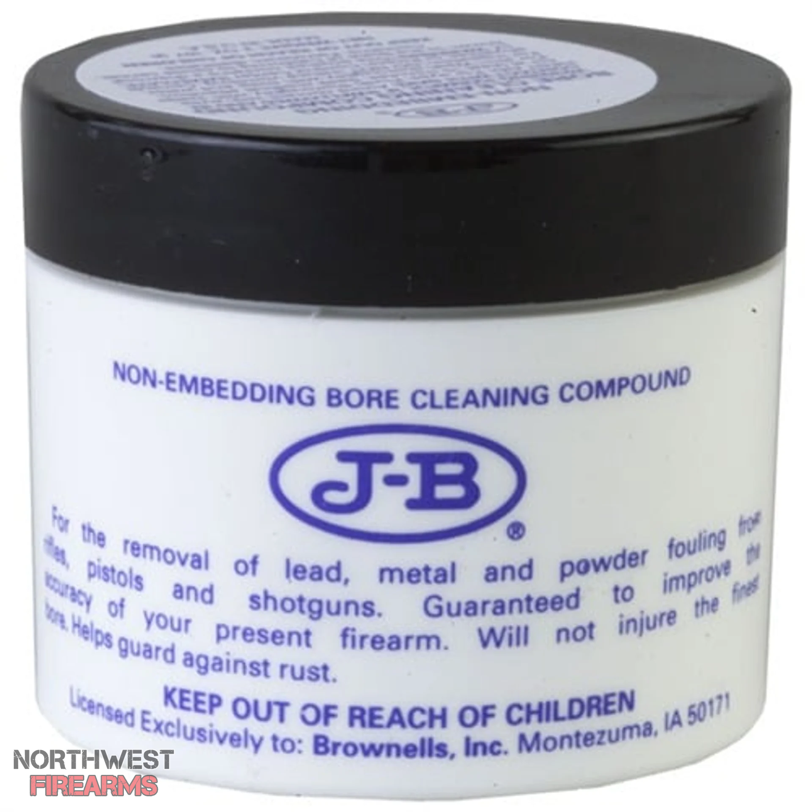

I have never used the bullet lapping system but I have been using JB Bore paste for many years. It is recommended
by New match barrel manufactures like Krieger and White Oak. It is used for break in and cleaning every
1K rounds for removing the dreaded carbon ring. I have smoothed up barrels that reduced the group size in half.
