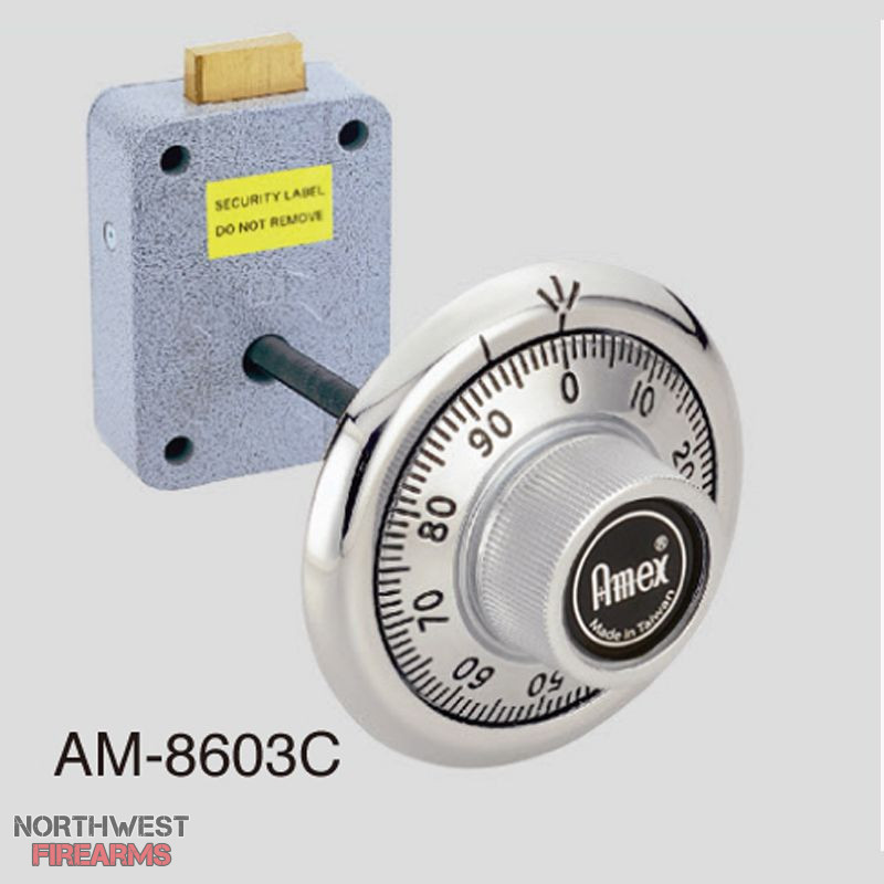

If not. The lock itself usually isn't too hard to swap. The lock is on the inside of the door, the keypad or dial is on the outside. The dial is the part that can be hard to install if the safe wasn't designed to take a dial. If their is no port for the spindle, then your sol. Most safes use the hole originally meant for the spindle to allow the wire to pass through for electronic locks.
Here is a good picture to give you a visual idea of what I'm talking about.

If that's the case it's pretty much just unbolt, bolt. It will probably take you longer to get the backing off the inside part of the door.
Most gun safes have a straight spindle to the lock, the more expensive safes have repeaters, to make it harder to drill.
