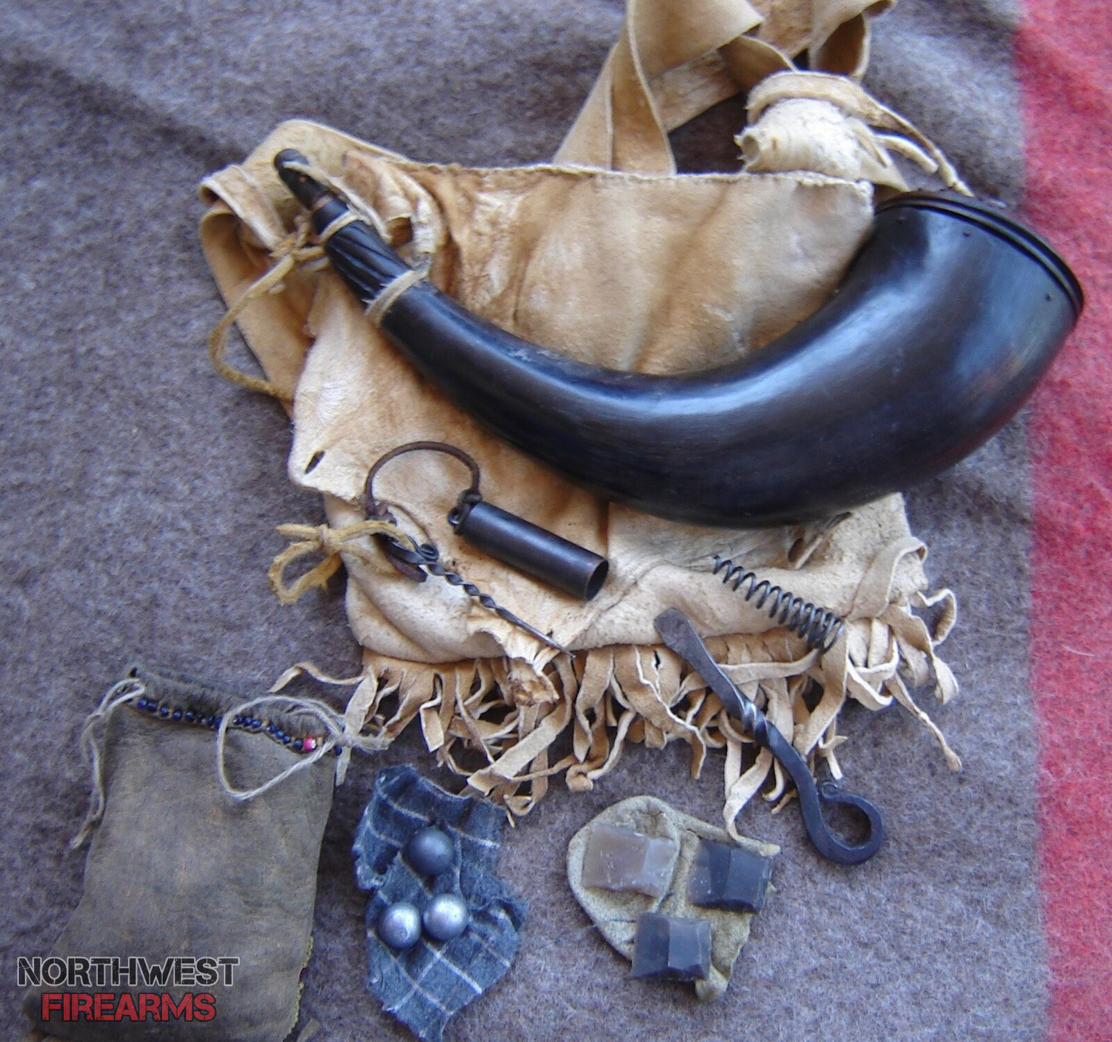

A shooting pouch I made....it came from the same hide as my jacket mentioned earlier.
( I made the powder horn as well...)
