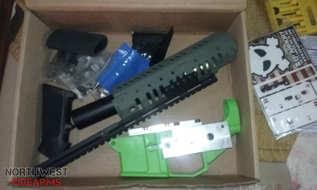

For the Worthless Without Pics crowd, where it is right now in its project box:

Be careful with the EP lower I got one of those green lowers and messed it up trying to mill it out using there stupid stickers but I see you got a jig I got one too now BUT TO LATE FOR THE EP LOWER LOL
That's why I bought the jig at the same time... AND bought FOUR of the frickin' things, fully expecting to write-off at least one, more probably two and at worst three. I have to say this is going more smoothly than expected so far, other than the hand injuries... this is the first one, but it's not one yet and plenty of chance for Murphy to sneak in.
