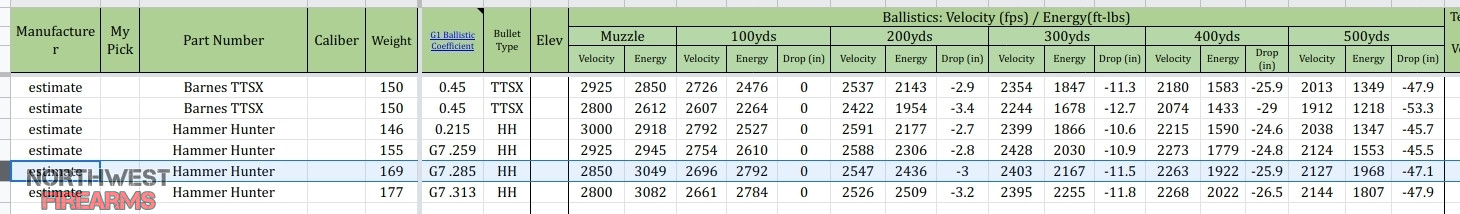

I'm buying components to handload a new 280AI for elk hunting. Ive narrowed down to either a Barnes TTSX or a Hammer Hunter. I'm looking thru the various weights they offer and kinda stalled out on picking the heaviest or choosing a lighter weight. I'm playing around in a ballistic calculator but don't really have a metric to judge a starting velocity for each weight.
Barnes TTSX: 140, 150gr, Hammer Hunters: 146, 155, 169, 177gr.

1:8 twist, 26in bbl.
It seems like all my estimates in this caliber easily reach out above 2000fps out to at least 500 yds. Im not certain I want to go lighter than 140g but Im open to ideas.

Now theres a metric I can use but it leaves me wondering if the heaviest option will lose more velocity at longer range than a lighter version. I just dont have a way to accurately estimate muzzle velocities to estimate ballistics. Im leaning towards the 169g at the moment.
