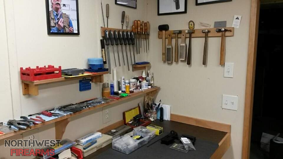

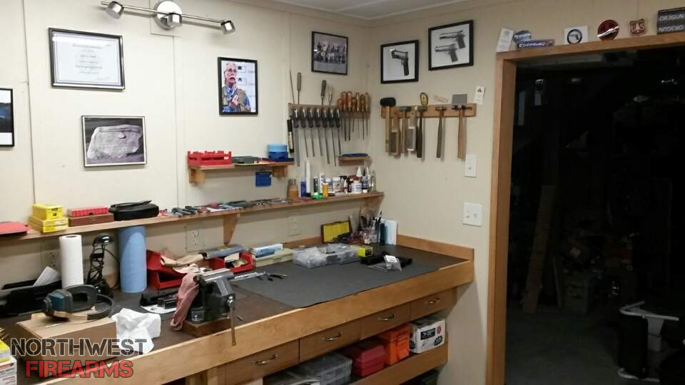

Here's part of my new shop I just finished, still working on the other half.
There are most likely many better talented 'smiths than me on here, I'm definitely not the end all...and I hope they chime in and give some advice and help out.
As with my firearms training school, I'm always willing to help out anyone wanting to break into the biz, I think it helps out the industry as a whole.
