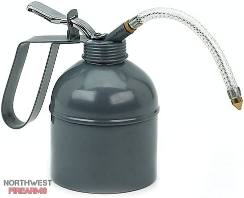

I use a thumb pump oil can with 0w-20 in it. I'll pull the pins, separate the upper, turn it on it's rails and give the bolt a few splooges.
Mine has the old, coiled steel goose neck.
