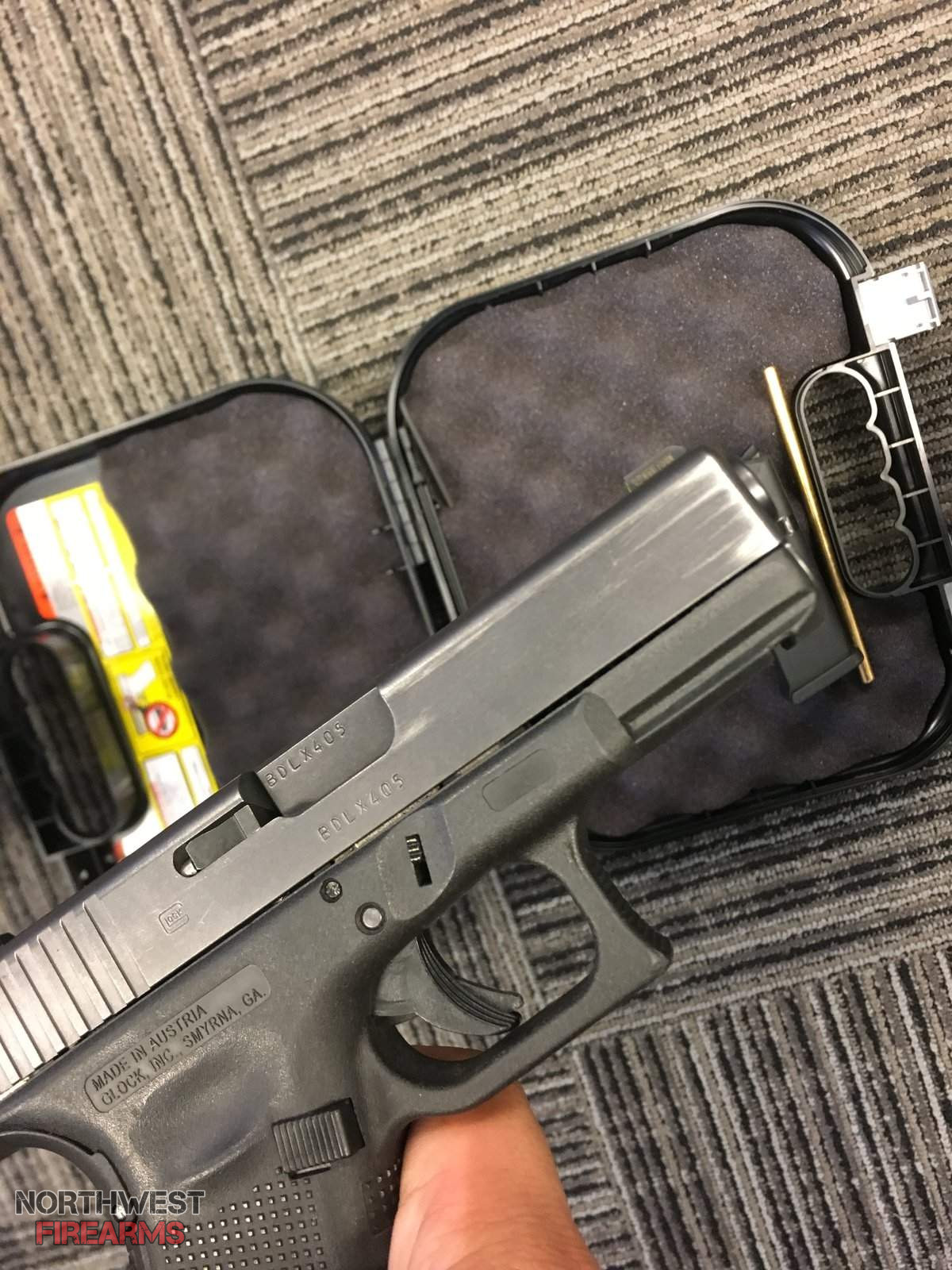

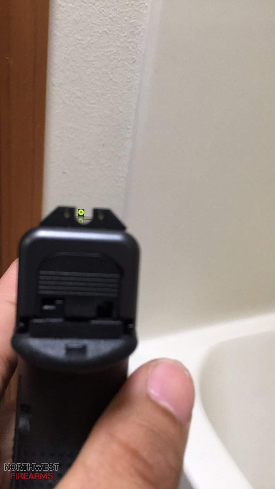

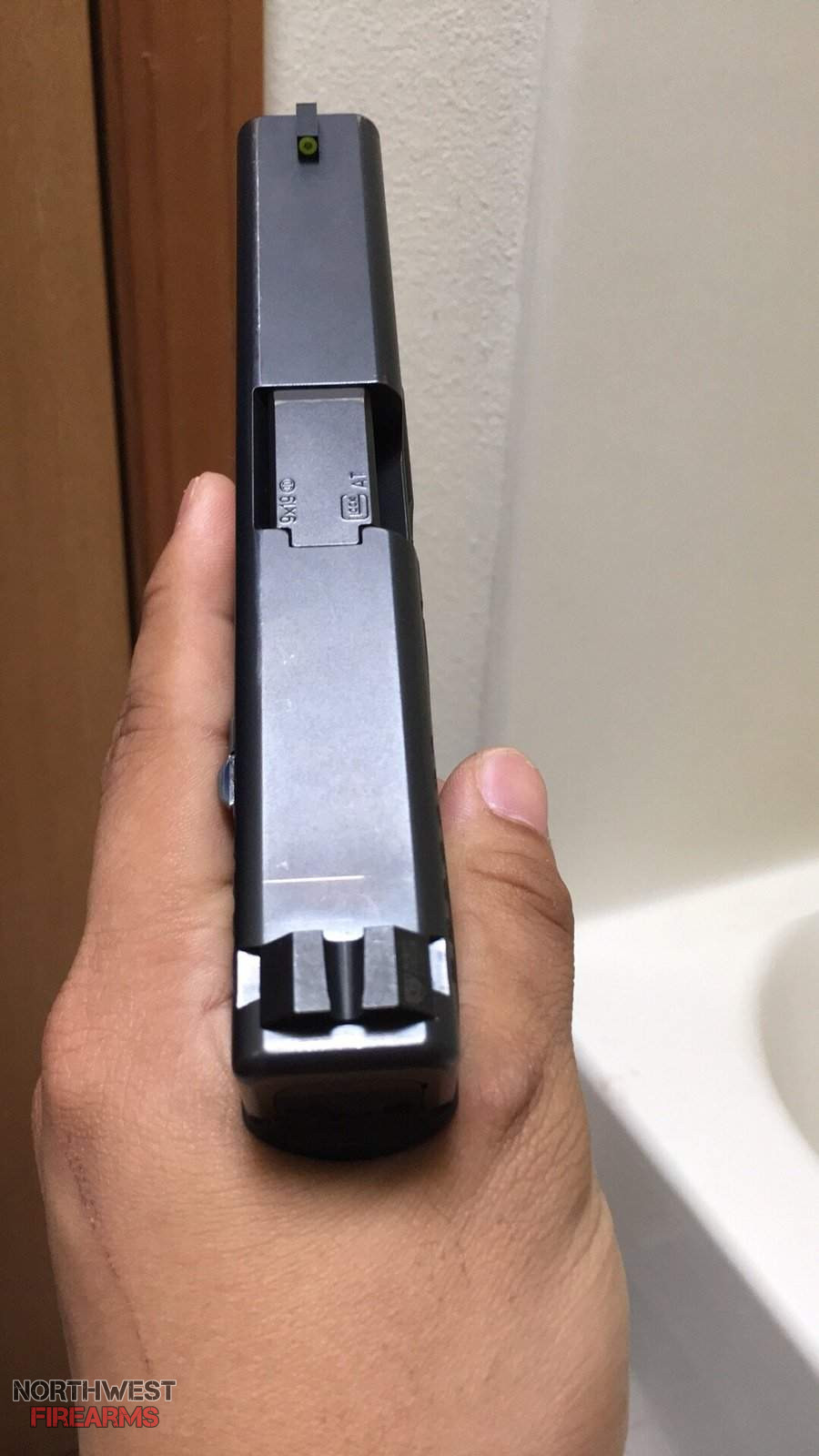

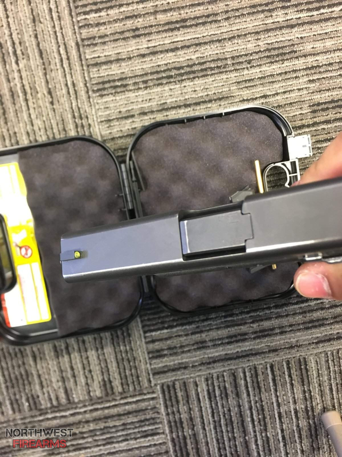

Took an hour long drive to Safefire/Brimstone. Beautiful looking facility. Cost $20 for the rear sight installation however upon closer inspection the rear sight does not appear to be centered. I was short on time and it was late so i couldn't get a detailed look at the sights. May try to contact them soon to see if I can have this corrected for free or maybe just take it to NW armory
Update:
Try shooting it before you move it.
