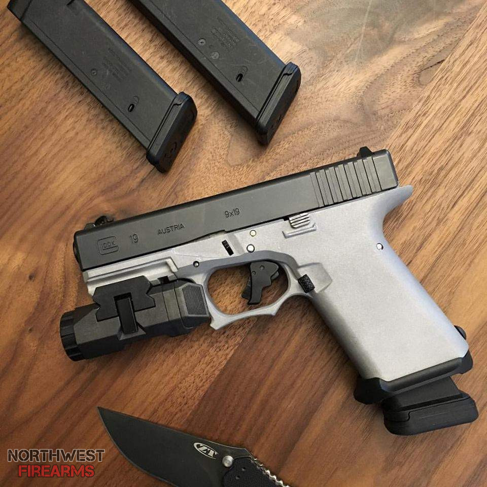

Well here is my Spectre 80 build. Honestly it was the easiest build I have done. I was very surprised at how well it "fell" together. Can't wait for the 19. I already have a line on a complete slide for that one.
