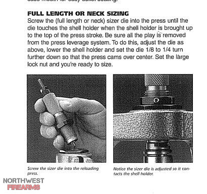

Yes. Tight die to shell plate
I think that may be your issue. After seating the die flush with the shell holder you need to lower the shell holder and turn the die another 1/8 to 1/4 turn lower so it cams over. Then set the lock ring.
Yes done that. With both the old RCBS and new Hornady sizers.
I been reloading since 1950s
Well heck, what are you asking us for then? You have been reloading for longer than all of us combined. I honestly doubt that the guys editing the RCBS reloading manual have been reloading as long as you have.
